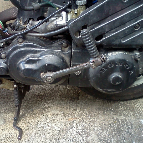

I think what you have is a AF16 (94-01 SA50) engine that someone swapped into your aero. They then removed the gears and cover from your original AF05 that came on your aero and put them on the AF16. Like I said from the pictures the following parts appear to be off from a SA50

Re: 1985 Aero needin some help.
Yes, but the early SA50 Elites also ran an AF05E, as did the SE50 Elites. The engine number needs to be looked up but my source book got stored when I was not looking a month or so ago.

Wow you guys REALLY know your stuff. Anything I can check to identify what it really is?

I can take more pics of anything on the motor that you need to see.
Post by Duke »
Looks like an AF16 to me. That's a real score man!! :)
Duke wrote:Looks like an AF16 to me. That's a real score man!! :)
Since when is and AF16 marked AF05?
Post by MopedMark »
As I stated before when they swap gears out of the AF05 into the AF16. Swapping the gears from the AF05 which I think are 10:1 is a cheap upgrade.
MopedMark wrote:Swapping the gears from the AF05 which I think are 10:1 is a cheap upgrade.
Can be reasonable cost, but takes tracking down the correct model. Of all AF05's, only the '87 SE50 got 10.2:1, and only the non-restricted version. The rest of the AF05's are about 11.1:1
Post by Duke »
Yeah a bit of a Frankenstein but in the best possible way!
Post by evilone »
The trans cover that was originally on the motor will verify it's an af16 :roll: .

What is it?
Post by SpamMusubi4Life »
Bear45-70 wrote:Yes, but the early SA50 Elites also ran an AF05E, as did the SE50 Elites. The engine number needs to be looked up but my source book got stored when I was not looking a month or so ago.
Where is the engine number located?
Post by paulpauly7 »
it would appear to be a af16 that has had a af05 gear swap it may well have been done to retain the original engine code that matches the papers rather than a mod for performance
So its an af16 with af05 gears n cover you guys say. Also I was trynna figure out why it doesn't pull after about 33 mph. I pulls strong till it hits about 33 and then it just stops, like it runs outta power. Its still screaming but not pulling like it should. Any suggestions?? Its still stock carb but running a #95 jet, also has 9g weights.
