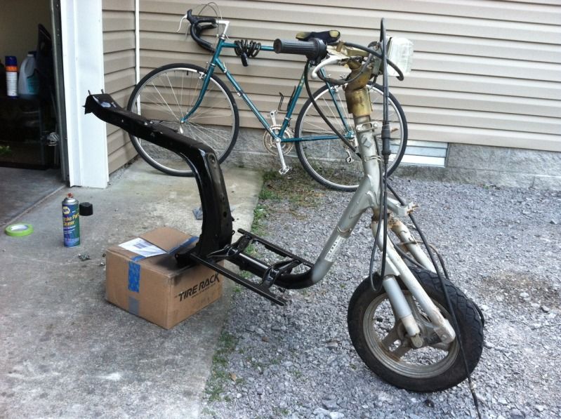

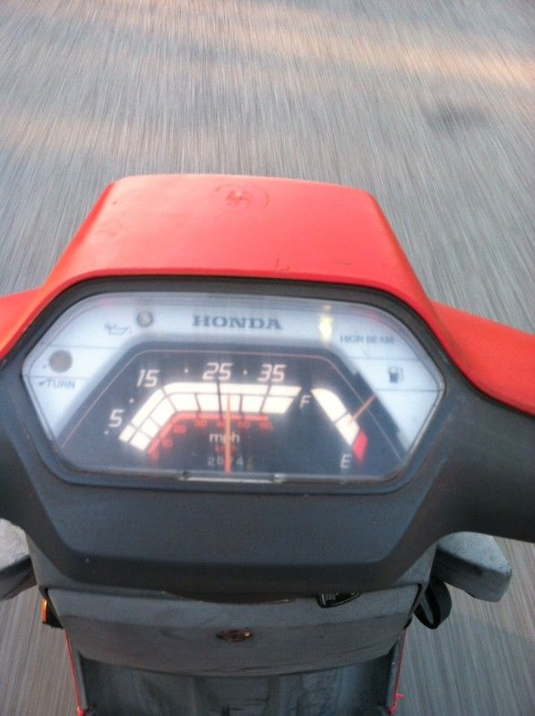

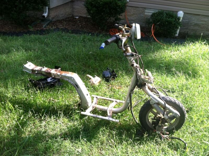

I figured it's time to start a build thread on my scoot since I decided to go ahead and strip it down to the frame. Here she was as purchased. It ran, but I could only manage 27mph out of it :*:
Yesterday, I got frustrated by all the grime and dirt, so I decided to pull it apart and do this properly.

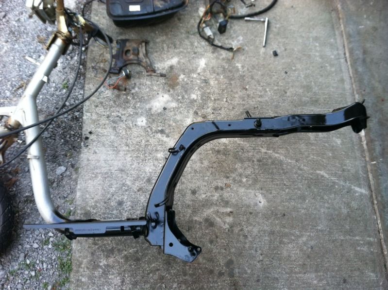

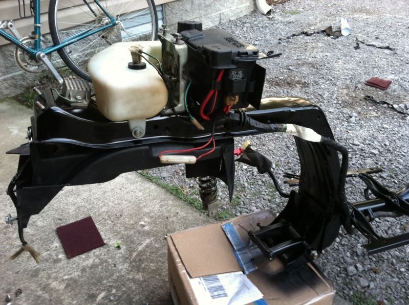

Today, I pulled some more stuff off, cleaned & painted the rear half of the frame, & re-wrapped the harness. I'm going to wait on painting the front half of the frame until the engine is back on.
Shiny :2thumbs:

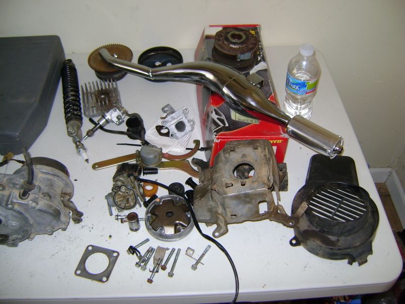

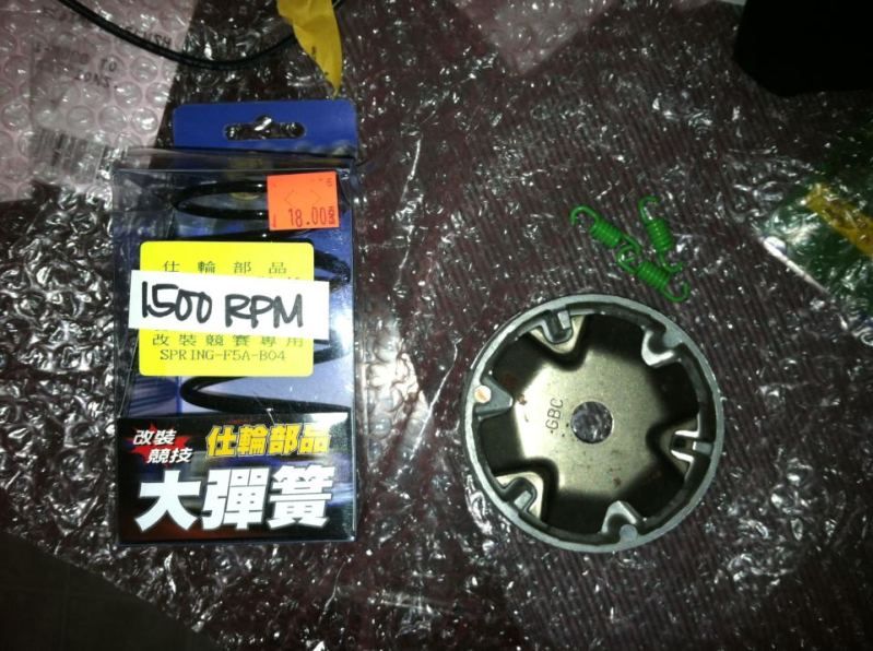

I have a few parts in transit to me as I type:
Polini 2k green clutch springs
1.5k clutch torque spring
Ruckus variator & rollers
OEM Honda drive belt
Pocket bike exhaust
A few new (to me) plastics

I could go ahead and do a swap, but I agree... where's the fun in that. I decided to see what I can squeeze out of the stock bore AF05. Speaking of, I'm having a hard time finding main jets for this carb. Should I go that route or just spring for a bigger carb/intake? What would you guys recommend?

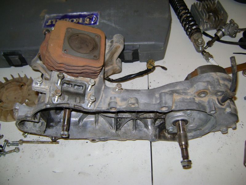

Oh, also a small update. I finally had some time to start cleaning/disassembling the engine. She's getting there. Also got some new parts in too. And on a side note, I scored a good deal on a '08 Ninja 250 today :woot:
What a mess...
A few new things from daywot and the TotalRuckus classifieds...
