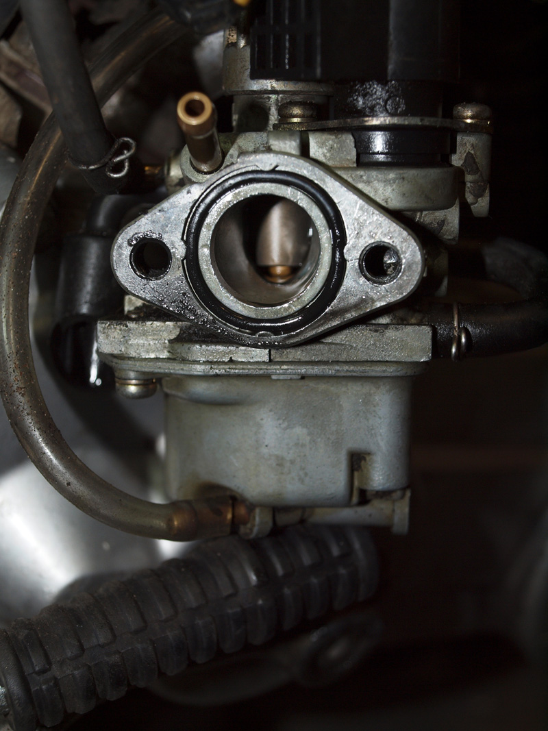

Here are pics of what I am asking about where a gasket should be
I believe there should be a gasket between the carb and the the intake.....am I right??
- carb towards engine block 800.jpg (252.67 KiB) Viewed 4137 times
- gasket area 800.jpg (225.71 KiB) Viewed 4137 times

Re: Honda Elite ES doesnt idle/run right; Carb question
Hmm, I suspected you didn't have this part. It's not a gasket but a plastic part about 3/16" thick and housing a second O-Ring that is needed to seal between the manifold and plastic. Its thickness sets the carb in the correct spot to mount the airbox. Number 13 and 18 in this Pic.
As stated, 4 ways to install, only one works. Triple check that the carb mounting bolts can hold the torque specified in the manual - FROM MEMORY about 7 foot-pounds - double-check in the service manual. If the o-rings are crushed, kinked or split, get new ones. Don't even bother trying to tune the scooter if this mount isn't Perfect and air-tight.
Did you click on "This Pic"? It's the same color as your reed block, shaped like the manifold flange.
Wheelman,
I am a stupid Old Man with bad vision...LOL!
Checked the diagram on This pic......that was a huge help for me as I am learning the ends&outs of working on my Honda.
I believe that part is on the carb.
I ended up going to local Auto Zone, got some carb gasket material, cut out my own and installed.
Guess what...it is back to running a smooth 30 mph with no problems. I though it had been running at 35 earlier, but I may have been mistaken. There is definitely no sputtering, slow-down or other problems at this point, so I believe I have fixed the air issue with the gasket. Guy at AuoZone said the gasket material should last about 30 years. I'll post more if I have any issues with the gasket, but so far...really good!
