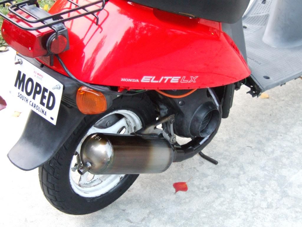

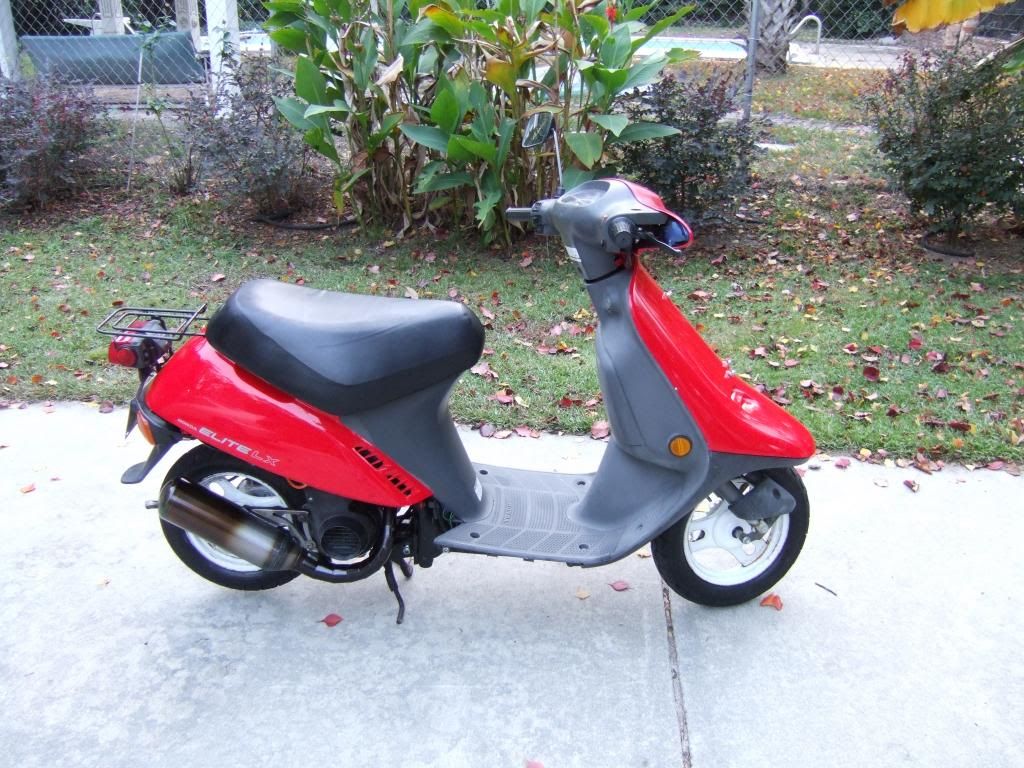

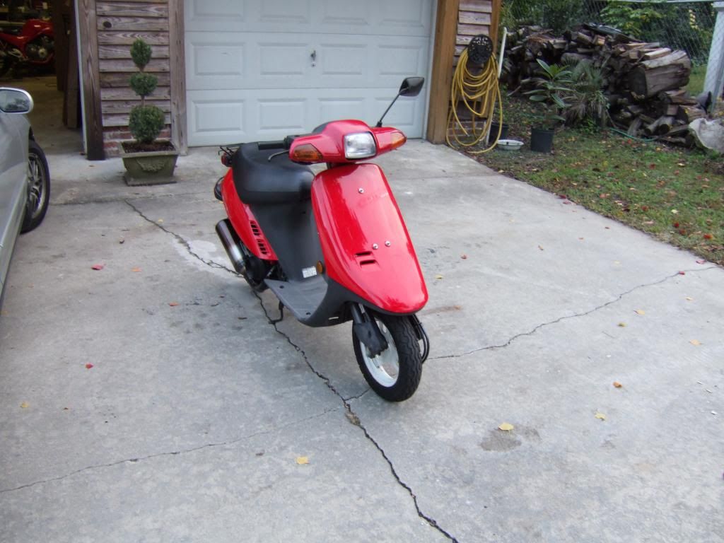

oh yeah i'm running 6 7g rollers 42g at present
here's a few pics of my torqueless buggy with the new pipe.
