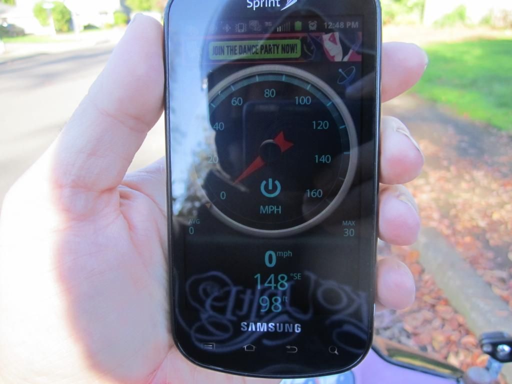

Did the speedometer test you recommended today. The top speed was 30mph (GPS), and that was indicating 36mph (spedometer), and usually I can only go about 31mph (speedometer).
So looks like my cruising speed is about 27-28 is all I can get out of her right now.

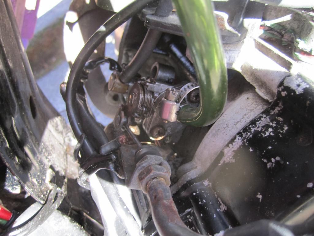

This is the oil problem I am having, but I will be installing the oil plug tonight and cleaning the carb, I will include pictures. I will also look at the variator as requested. I will include pictures. Doing a compression test tonight, and I will include pictures.

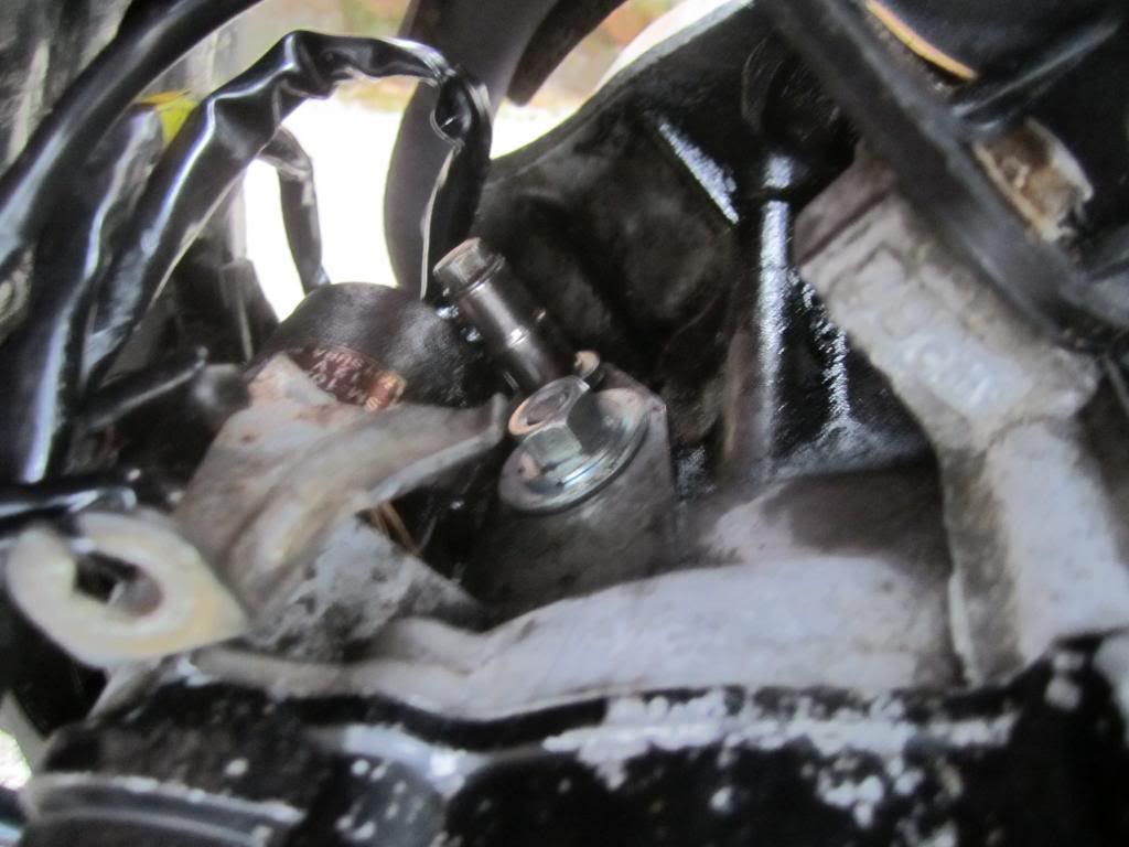

Okay guys, here is my oil plug, I had to sacrifice a 7mm socket to the cause, but it worked well until I buy a correct length bolt.
Didnt get a compression test done yesterday, however, the bike feels completely different with the plug in and the oil pump removed. Night and day, no faster top speed, but considerable midrange difference, still a dog, but made a difference.
I am wondering if the oil plug had not seated with the crankcase or was somehow letting air into the crankcase and that was causing the oil issue? I don't know, but I will hopefully do a compression test on saturday morning.

Re: SE50 with AF05E, what is the Cheapest path to 40mph?
If the o-ring on the pump wasn't sealing, it's absolutely an issue.
Spark plug socket is "standard" 13/16 I think.

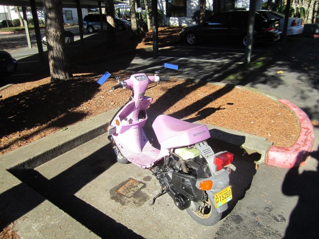

Make sure you used some type of silicone to seal that plug. If not your going to have a airleak. By the looks of your bike, you have the 87 elite s non restricted model. If your only seeing around 30mph. Sounds like that exhaust port might be clogged up with carbon. Or the airfilter is clogged up. Also if you haven't replaced the belt and rollers, i would do that too. That model stock does 40mph no problem.

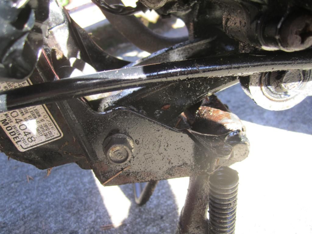

If that's the original motor , it should have the unrestricted US2 stamped plate.

there is two tips of se50 10/1 or 11/1 final drive as well as two diffident ramp plats the main jet one a 82 the other is a 85 ... dose he have a se50 or a se50p????
