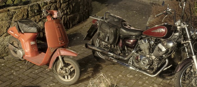

I bought an ND50 in running but horribly abused condition (bless them, they never quit) and I'm in way over my head. I've got a history of mechanics, but only with big stuff that has four wheels, rollcages, and a turbocharger crammed into every available space. A little scooter is a totally new thing for me.
The idea is that I'm going to strip it all back, de-rust, fix everything that's broken, upgrade what I can, put it all back together, and then give it away to someone who needs it more than I do. So far, I've done one of those things. Then I took a step back, saw the extent of my spanner-happy idiocy, and decided I needed some help.
Here it is the day I brought it back, alongside my current daily.
It doesn't look like that any more...

cool, you dont see them down my ways, so what have you done in this spanner happy expedition?
any more pics?
