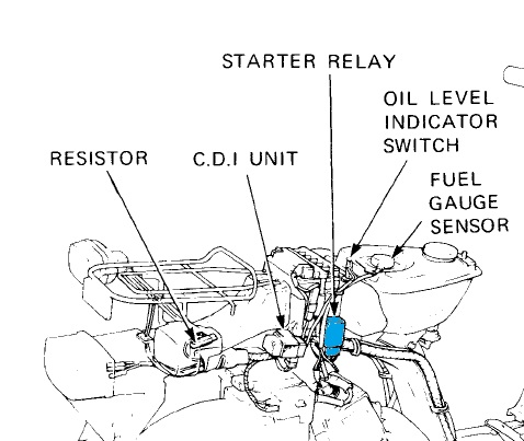

Re: 1986 Honda Spree with no electrical power
However, when I went to crank it electrically something clicked once like a relay or something (not the starter) and the rear light dims and temporarily goes off for a few seconds then comes back on. It's the relay on the right side of the battery near the oil tank that hangs there. It makes a click noise when plugged in and no click when unplugged. How do you test to see its bad?
That is the starter relay...
A common cause of the above behavior is a bad/discharged battery or poor electrical connections.
An failed starter or abnormal load on the starter can cause lights to dim.
-- Least likely --
If the contacts are open, your tail light should not dim when the relay is engaged...
Sometimes starter relay contacts go bad. You can check with a voltmeter at the starter red lead to ground and see if there is voltage when the starter button is activated.
Starter Relay:
