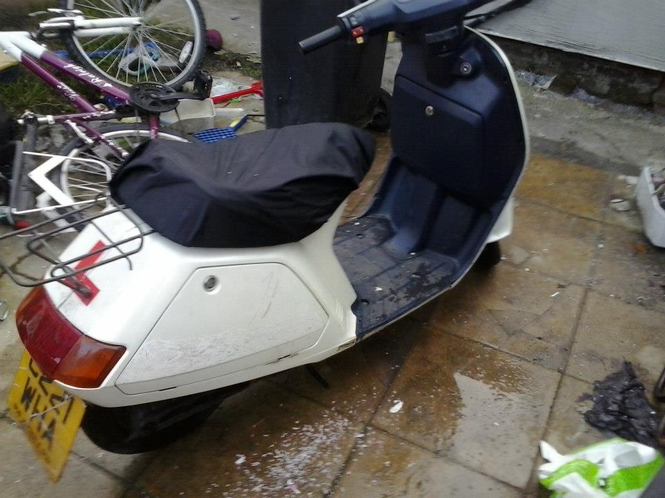

regarding the colour it says on your papers, shasta white, spoke to a friend who does resprays for a living and is going to be respraying my vision, he says that my one is shasta white, just thought id let you know, heres a pic of mine, just a example of what shasta white is...................
