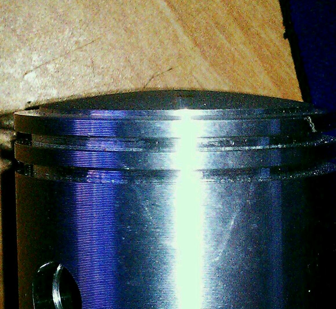

Yes you use the stock head for the kit on the af05e, there are actually people on here who have used the kit. I for one. The cylinder is actually domed to reside within the stock squish zone. I have an extra piston and stock head milled to 47mm, which isnt needed, if you ever need a replacement as well. The cylinder should be chambfered in my opinion when you get it also. These pistons are not dished and yield 120 +/- psi in factory form with one base and one head gasket.
They are good cylinders for the money but dont forget they are aluminum and keep your temps safe.

The piston is domed actually.
- IMAG1220-1-1-1-1-1.jpg (224.7 KiB) Viewed 9013 times
Re: Airsal BBK
LMH's pics are worth a few hundred words. Look at that section around the rim of the piston crown. That's how they make it fit with the 41mm head. It's a bit surprising that compression doesn't increase to more than 120 PSI. You are stuffing a 65cc gulp of mixture into a head volume that was calculated to be for 49. Has anyone measured the compression of a stock piston/head before mounting a Big-Block?
