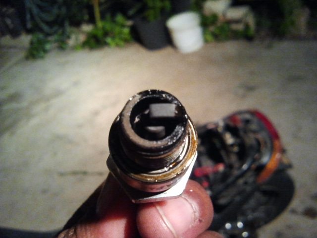

Manifold, schmanifold! What's the CHT say? What does the plug look like? All intakes feel cool running. Don't go by that to determine your jetting.

Re: 120cc stroker jetting need help
H
- Spark plug
- 2013-01-22 21.03.34.jpg (97.29 KiB) Viewed 9902 times
put a new one in and do a proper plug chop
That was a new one but I can put another new onepaulpauly7 wrote:put a new one in and do a proper plug chop
