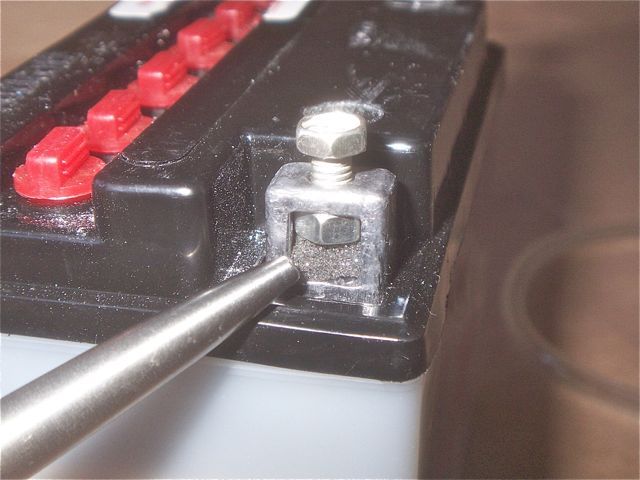

On some batteries the screw will not reach the battery bolt terminal once the connector is on .
Here is what I do too solve the problem .

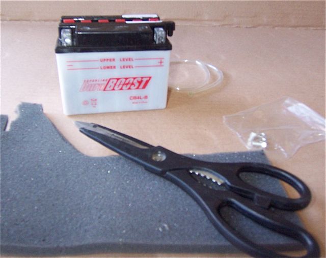

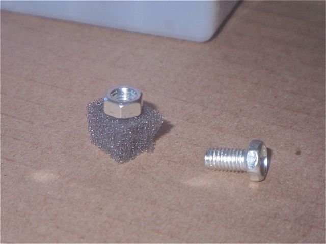

Take a small piece of foam cut it a little larger than the terminal hole .
stick it and the nut / lug into the terminal hole / The foam will hold the nut in place .
No more messing around trying to catch the threads in the nut or having them fall out if you tilt the battery .
What could be simpler than this ?
all you need  sizzor  / foam / nuts & bolts  and a battery .
The foam holding the nut in place .
