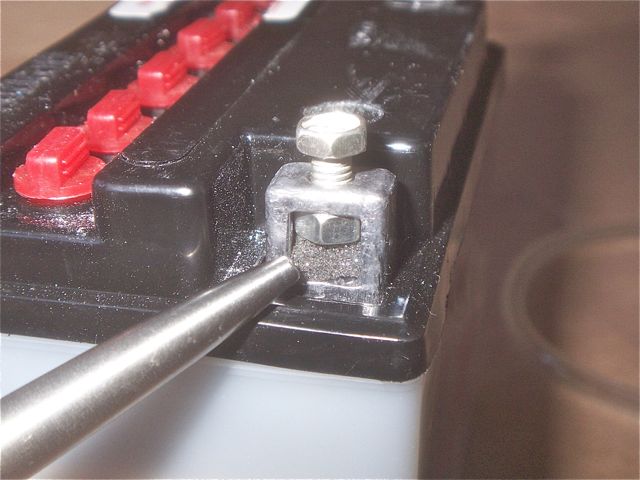

Fumbling with the lug and getting the battery bolt started in it can prove to give serious headaches. To avoid this Houdini-like process, I suggest using either a short piece of shrink tubing, or a common drinking straw.When inserted into battery post with the lug, a firm pressure will hold the lug in the desired position. Works well either way you need to use for your application. Whatsmore, no need to remove as there are no conductivity mishaps possible...... :urban:

Re: Battery Installation Tip

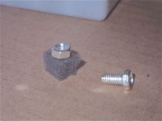

Mike why are you doing this the hard way ?
Come on save yourself some trouble 66SIX will show you the way shrink tube are you kidding ?
Batteries are always a problem .
Here is a dumb tip .
On some batteries the screw will not reach the battery bolt terminal once the connector is on .
Here is what I do too solve the problem .
Take a small piece of foam cut it a little larger than the terminal hole .
stick it and the nut / lug into the terminal hole / The foam will hold the nut in place .
No more messing around trying to catch the threads in the nut or having them fall out if you tilt the battery .
What could be simpler than this ?Mike try shrink tube on one side and the 66SIX foam on the other side see which one works best ...
Foam / not shrink tube ... Come on Mike ...
