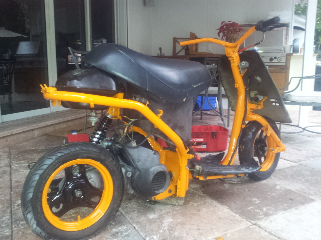

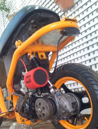

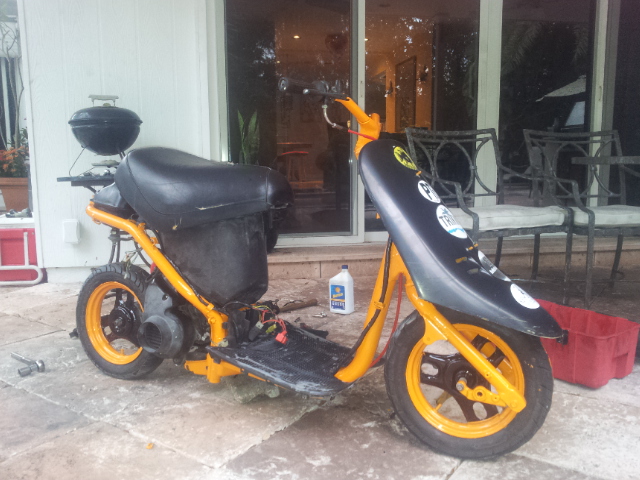

My 90cc elite with a 30mm carb and a 32mm exhaust almost done

Re: elite project
Love the paint job great colour scheme
but there is a possibility that you may have trouble using a 30mm carb on a 90cc it might be a little big. Might be fine with the big pipe though.

Re: elite project
I also have a 24mm should i use that one instead
Re: elite project
What cylinder and crank? 30mm will be tricky to tune for rideability, but 26 or 28 will be faster than 24 on top. Treatland and at least one Forum member can sell you a 28 for around $75. You can sell yours for around$50 a pop used.

Re: elite project
Stock crank and 50mm bore kit is going to b on e85 thats why im runing a 30mm e85 requires alot of air and fuel
- patthesoundguy
- Posts: 3019
Re: elite project
E85 prob won't require the extra air, its the extra fuel that will be needed. You have both carbs so if the 30 turns out not to work you can always swap out to the 24. As long as the carb is jetted right so it gets enough fuel and you dont seize anything you've got nothing to loose but try the 30mm and see what happens. If it were me I would run the 24mm and get it dialed in for break in and then then try the 30mm. Give it a go and let us know how it works, E85 is kind of a new frontier and any info at all on what works is awesome and I'm sure the rest of us will benefit.

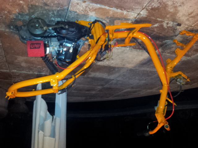

Re: elite project
Gas tank under seat

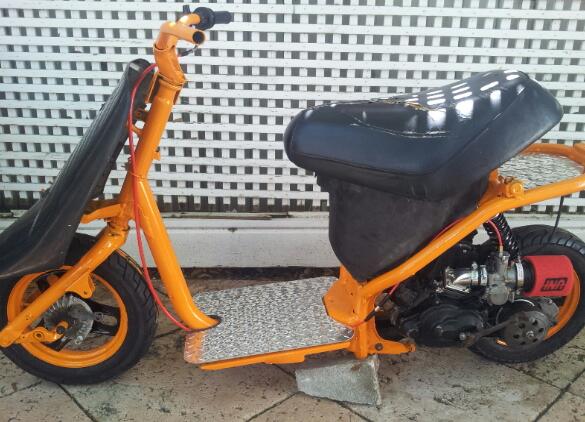

Re: elite project
Did a complete wire tuck even the ignition key is under the seat it looks like a ruckus
- Elite project
- 20130218_121501-1.jpg (30.94 KiB) Viewed 6990 times
Re: elite project
As you know you should match the crank to the bore, so your crank seals will blow real fast
btw mustard & black paint is hot, front shocks are needed....

Re: elite project
Yea the shoks are on the way this one is a stock crank i just use a really thin base gasket to get more compression
