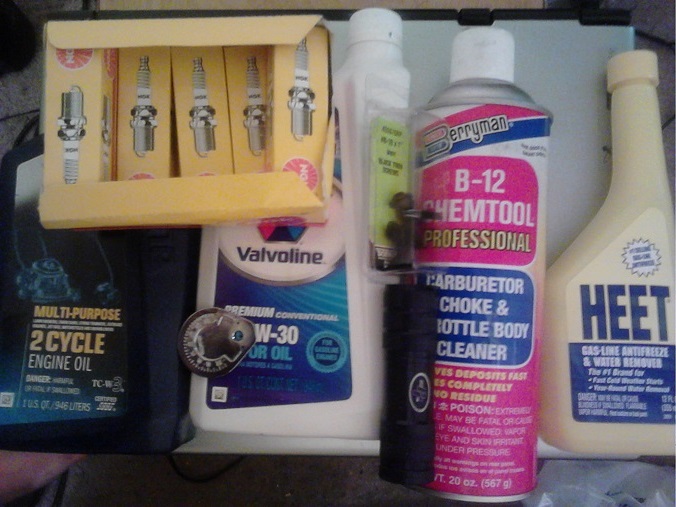

I got the goodies!
Parts store had 6 of the plugs and I bought em all.
Got oil for the engine, oil for the air filter, gas
additive to take care of any water in the tank.
I am going to use 1/2 teaspoon for a tank of gas.
3 tanks and that's it. I got the spark plug gap tool
for the .25 thousandth spark plug gap. Screws for
the air box, and even a stubby screwdriver to screw them in.
Plus, a small, single super bright led flashlight.
- Goodies.jpg (118.08 KiB) Viewed 6038 times
