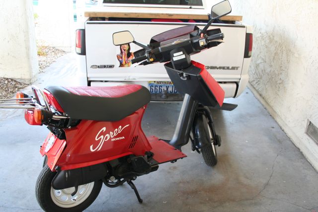

Here is a photo of my Elite 80
I made some changes and stuck some SPREE 50 side panels on it .
"Elite 80 exhaust pipe cracking"
The header design on this pipe is somewhat poor. The pipe will crack near the exhaust port on the engine, where the pipe bends. It can be welded or brazed with a little work.
