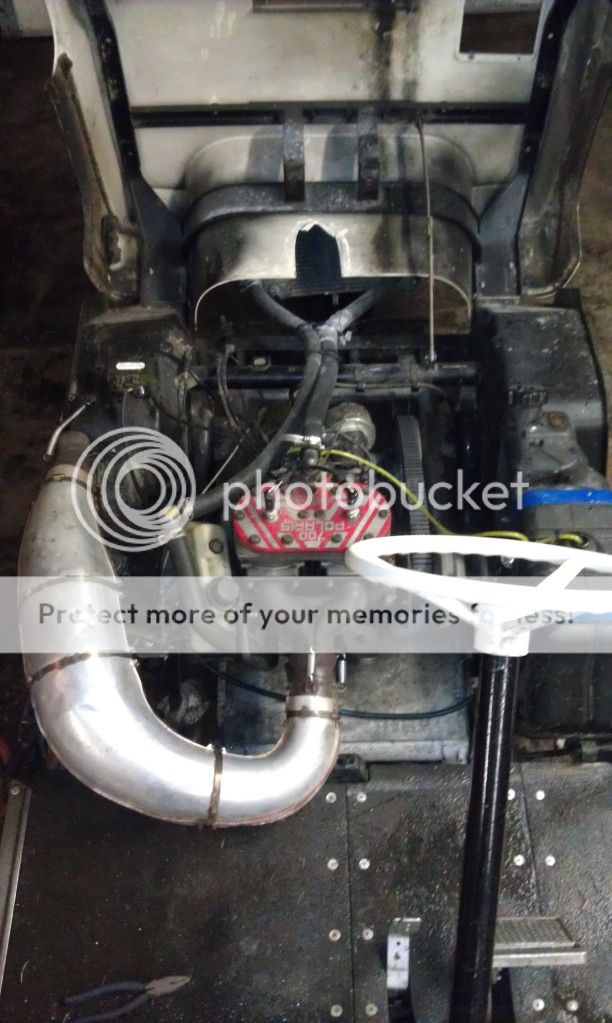

700cc golf cart vidoeo
- Trafficjamz
- Posts: 5013
- Location: Eastlake, MI
I know I know its not a scooter.
But it is a two stroke, so I thought I would share my latest project.
http://www.youtube.com/watch?v=UYjjI-HG7gY

- Posts: 3675
- Location: Iowa, USA
Re: 700cc golf cart vidoeo
What clutch and weights are you using?

- Red Eft Performance
- Posts: 351
- Location: maine
Ha cool what motor is it? Did you use the golf cart secondary clutch and drivetrain?
The engine is from a 1999 polaris snowmobile. It has the stock clutch (which is the primary)
The secondary pulley is the stock pulley from the yamaha golf cart.
The belt is from the sled.
The oil tank is from a spree.
- Posts: 3675
It will be interesting to see what jetting you end up with at the track. Please post back after tuning and the ambient temp.
