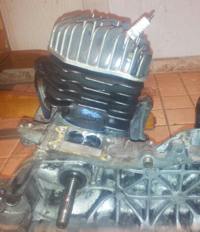

This is a full list of what i got 50mm kit from chopchop123 44mm crank from autotech355 intake and exhaust ported 30mm carb with a 66 pilot and a 185 main on e85 a 200 dollars 125 cc drag pipe from jiangwayne stock coil and cdi honda ruckus variator with 9 grams rollers stock clutch with stock springs and 6-5 primary gears this is all u need to run 80+ mph now u need to cut the butom of the piston a little so it dont hit the block when it goes down but thats is simple and one more thing this is a every day driven scooter is my ride to work and super reliable

Intake ports

Engine
Engine
Engine

That is a nice lookin scooter bro. I am glad my 50mm BBK worked out well for you. They are good long lasting kits if broke in correctly.

so what cc is this engine

Is a 50mm with a 44mm crank they call it a 90cc
Re: 86 mph elite
slow elite kw wrote:Is a 50mm with a 44mm crank they call it a 90cc
They do call it that :crazy:
But it is really 86cc :smile:
