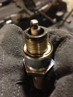

Have you done a plug chop at 3/4 throttle? That's how you're going to see if you are lean or rich. Do you know how to do a plug chop? After the chop, you pull the spark plug and look at the color down in the ceramic. Wet, black is rich. Dry tannish brown is safe. Dry light tan or white is lean, unsafe.

I just did a plug chop and I'm getting a white color. It's white on one side and darker tan on the other. Question is, how do I make it richer?
I'm premixing oil and gas at about 32 to 1 right now. I have the screw on the carb (one w/out the spring) turned 1 7/8th's out and my air mixture screw (one w/ spring) turned out almost to the point where my tire is not spinning at all when on the stand and idling.
I am running Taz's big bore kit 48mm and I am carefully breaking it in, which is why I am being super cautious about the plug chop.

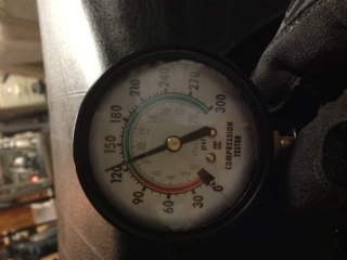

I also did a compression check tonight to make sure all is A-OK and it was holding at about 124 (did the test after a short ride. WOT during compression test too). I know it's good there.
I have a larger jet, the one provided with Taz's kit (from ebay) and along with it I have taller gears, and 3, 1" holes in the air box with uni filter plugs in it to open up the air flow. (Otherwise it goes slow) What do I do?

check for air leak or exhaust leak. the white on one side is the tell tale sign. try tighten the exhaust flange nut and see if its loose. check head bolts too.

i wouldnt be running it if the exhaust isnt properly secured
