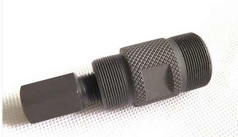

Re: looking for a flywheel tool for a spree
I think 24mm RH thread covers all Honda Spree/Aero 85-87/Elite SE50, SB50 and SA50. Yet Honda 50cc flywheels are not always 24mm - Gyro uses 27mm LH and eliteguy50 says 27mm LH fits Ruckus.
I'd recommend a dual 24/27mm tool at around $15-$20. 27mm Left Hand will also fit the QT50 in your avatar.Ebay Link
Pic is from seller's thread:
