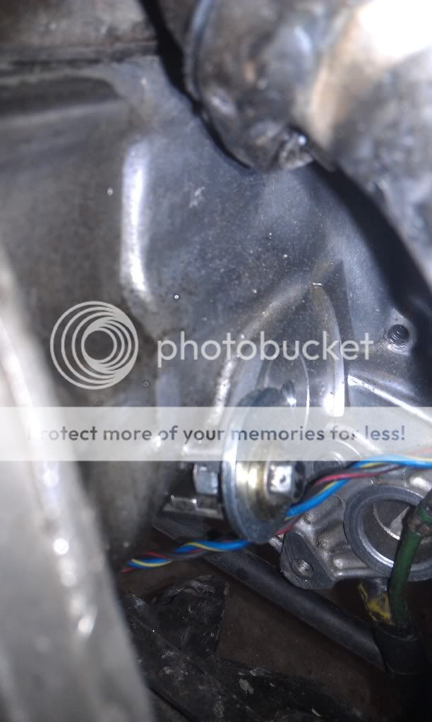

Re: oil plug leaking
sometimes the plug wont sit flush with block so you need to add a washer or two on top of the plug.Cherreh SR wrote:paulpauly7 wrote:yes you do need the washer spaced out to hold it in place the honda bond just helps the big job the little O ring has to do .
If you don't mind can't you explain this spaced out washer to hold it in place? I have no clue what you mean and I'm installing mine in a few days. A picture with an explination would be awesome if its not to much of a bother.
This is trafficjamz picture. looks like this plug is flush with the block.
