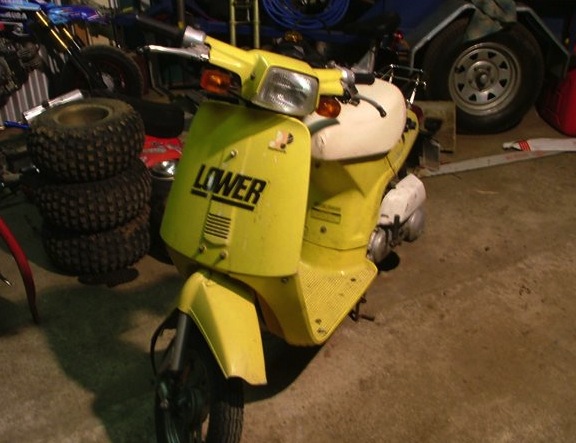

Ive posted on here a couple of times after becoming part of the Honda 50cc world. I recently purchased a Honda Melody (correct me if I'm wrong) in a non-running condition. The guy I bought it off told me It would run but would not rev out at all, he told me this was due to the carb being faulty. So I got it kind of cheap ($500 NZ) by the time it arrived.
Having some experience with small motors and carbs, I pulled the carb off to see what was wrong. I pulled it apart checked all the jets, checked the slide and needle and everything seemed to be fine. Figuring the carb wasn't the problem me and a friend spent a few hours trying to find why It wouldn't rev out. After a new spark plug, checking spark and fuel several times, I removed the exhaust to have a look in the port. While I was checking this, I pushed the kickstart very slightly, the motor burst into life throwing carbon etc out at my face much to my friends amusement.
Anyway, after realising that the exhaust was the problem and testing it and finding it had no flow, I was considering a performance exhaust. The exhaust that came on it had been cut open several times and welded back together so I didn't want to reuse it.
After hunting for a new exhaust it came apparent that exhausts for these scooters are not that easy to come by in my country, let alone a performance exhaust or other upgrades.
I had a guy at a local scooter shop recommend I do a engine swap to get more performance. After hunting for a while on an online auction sight, I found a GY6 50cc in working condition with everything to run for $100. I bought it and It is now on its way to me. (should be here thursday)
Other things I want to upgrade are the handlebars and controls, I want to run some sort of bicycle bars setup and maybe custom controls. Also I want to lower the front end slightly and when I mount the GY6, I will match It and also have some stretch. I want this to look clean and low. Not crazy low as I live in quake city NZ (Christchurch) and the roads are crap.
I may also paint it a tan-ish colour, not sure yet.
Sorry for the long winded post, I promise they wont all be this long. Hope to hear from some of you guys soon, Cheers.
