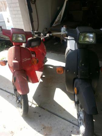

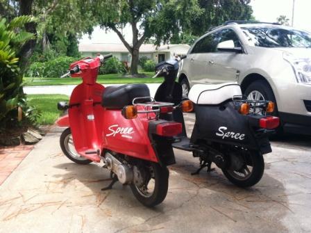

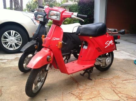

I wanted to introduce myself and show you my soon to be builds. Yes, buildsI bought 2! These will actually be my 2nd and 3rd builds since the first I restored was back when I was 15. My first ride was a Honda Eve we bought from an importer in Miami for $200 and my father and I completely rebuilt it. I had the Eve for a few years which got me back and forth to school, work, and all around town. While my friends were riding their bikes or getting rides from their momI was cruising in style! Its amazing that this little scoot fueled my passion for working on cars and engines for years to come.
Anyway, so now at 31, my wife and I live in St. Pete, FL and we love going downtown. I bought these 2 sprees to rebuild/restore so we can cruise the neighborhood and head downtown and run quick errands. I picked up both of them for a really good price, not running at the moment, but they are complete with all parts. The seller lost both sets of keys so IÔÇÖm having new ones made by a local locksmith, I purchased new batteries (they do have kickstarts as well), and will need to put some new tires on as well. My plan at the time being is just to get them running so we can enjoy them for a while before I take them all apart. I also have a petcock cover on order as well. They both have around 7k miles (does this sound high or scare anyone?). I will post some pictures as I go, but below is what they looked like when I bought them and after a quick sponge bath.
Thanks for looking!

- All Clean!
- 3.JPG (37.23 KiB) Viewed 11883 times
- Photo from the ad...dirty!!!
- photo.JPG (27.1 KiB) Viewed 11883 times
- My First Ride!
- Special K.JPG (36.99 KiB) Viewed 11883 times

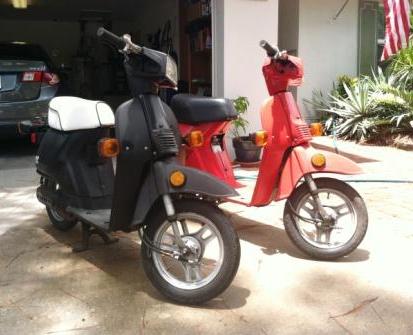

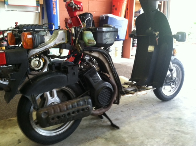

Some additional pics...
- 4.JPG (33.82 KiB) Viewed 11872 times
- 5.JPG (40.49 KiB) Viewed 11872 times

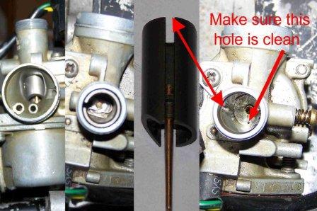

* I cleaned and removed the carburetor. It was actually a lot cleaner than I anticipated which makes me believe the previous owner had already attempted (more reasons confirming this below). All components were there and all the little holes were clear.

- imagecarb.jpg (40.24 KiB) Viewed 11815 times
Re: Spree Build...times 2!
Sounds like you are off to a good start. 7k is fine as long as you have good compression (who knows, maybe it has been rebuilt not too long ago). You might rent a compression tester at your local autoparts store or buy one if you plan on tinkering from time to time. Check the owners manual for proper spark plug gap it is probably around .025'' or so. Use fresh gas and make sure the carb is tuned by following the manual. The idle jet is a very good thing to have dialed in to ensure easy/ quick starts. The petcock valve is more than likely bad, replace it to prevent frequent flooding and wasted gas. Always make your carb adjustments with the filter on. Make sure your grease is not a liberal amount on the kickstart components because if some gets on the belt you will be unimpressed by the belt slippage. Some time you might inspect those brake shoes to make sure they are still good and not too worn. If you need the owner manual you can find it on this site under the honda owner and service manuals section. The gearbox fluid could be changed too if you feel like it, you might as well check the fluid condition/ level. I would take a sample of it and put it on paper to see how many shavings are caught in the fluid. Roll it around the driveway first to make sure it is good and mixed if it has been out of service for some time. Have fun!

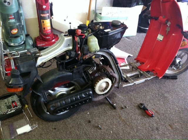

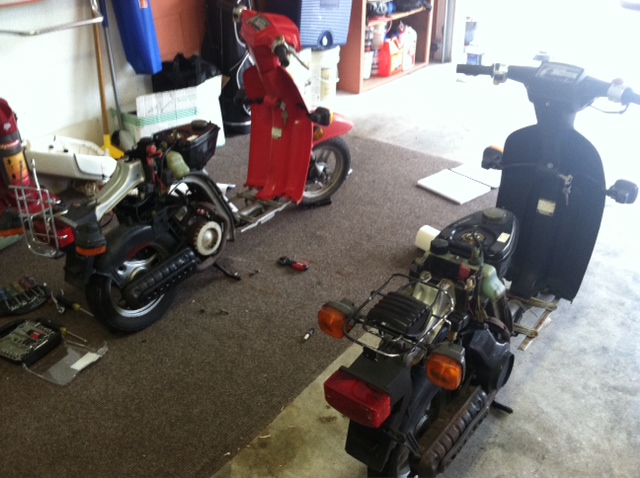

Attached are some photos of the builds...
Please note repair manual printed and bound in the second picture! haha!
- Rebuild 3.JPG (156.28 KiB) Viewed 11684 times
- Rebuild 2.JPG (128.65 KiB) Viewed 11684 times
- Rebuild 1.JPG (126.02 KiB) Viewed 11684 times
