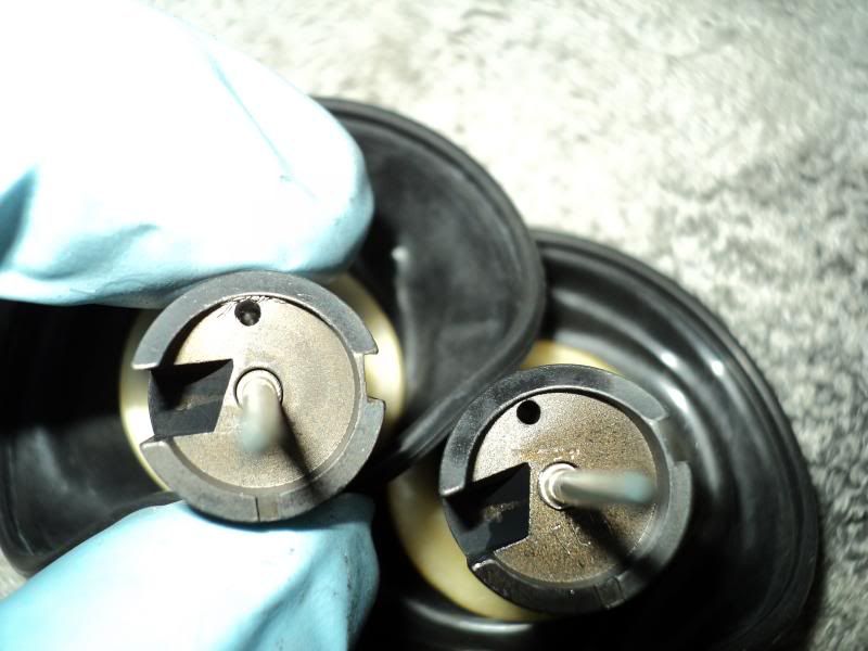

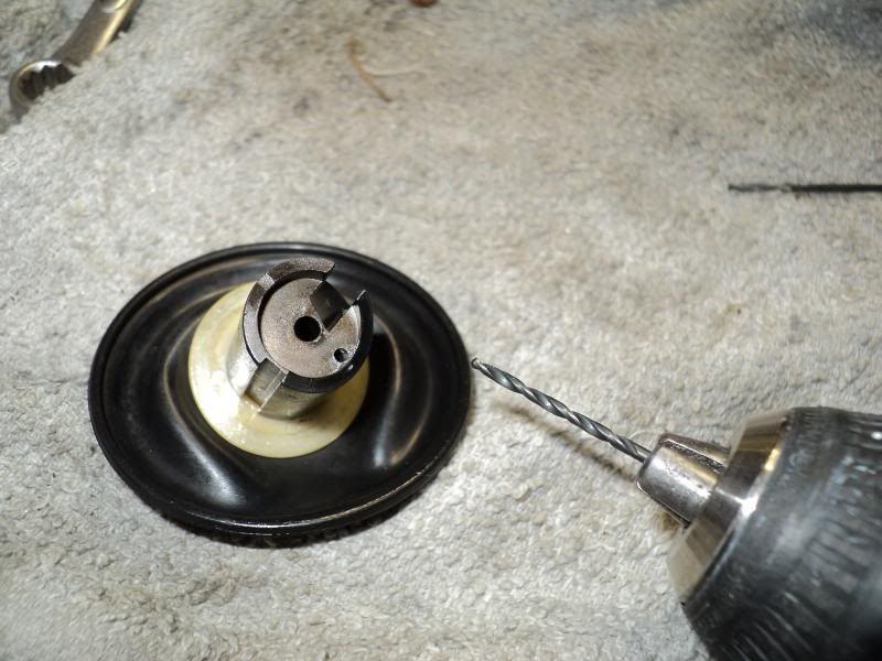

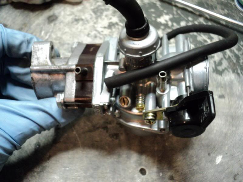

I decided to try a cv carb mod I've been researching, I drilled the vacuum hole slightly larger on the throttle slide. I noticed a little improvement with acceleration, not bad for a free mod.

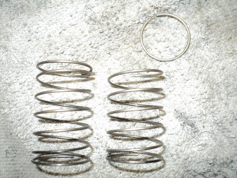

Trying another cv carb mod on the ch80, cut 1 coil off the slide spring. Helped with throttle response, a little better acceleration. Maybe I'll try to cut off another half coil someday.

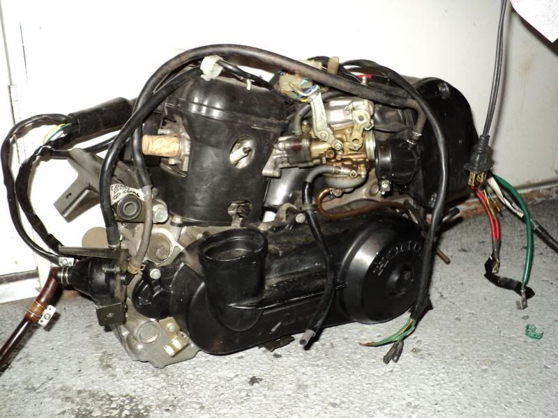

I bought another ch80 engine, now I have 2 spares. This newer model ch80 is nearly complete and looks clean. I'm planning on bolting it up to the spree and seeing how well it runs.

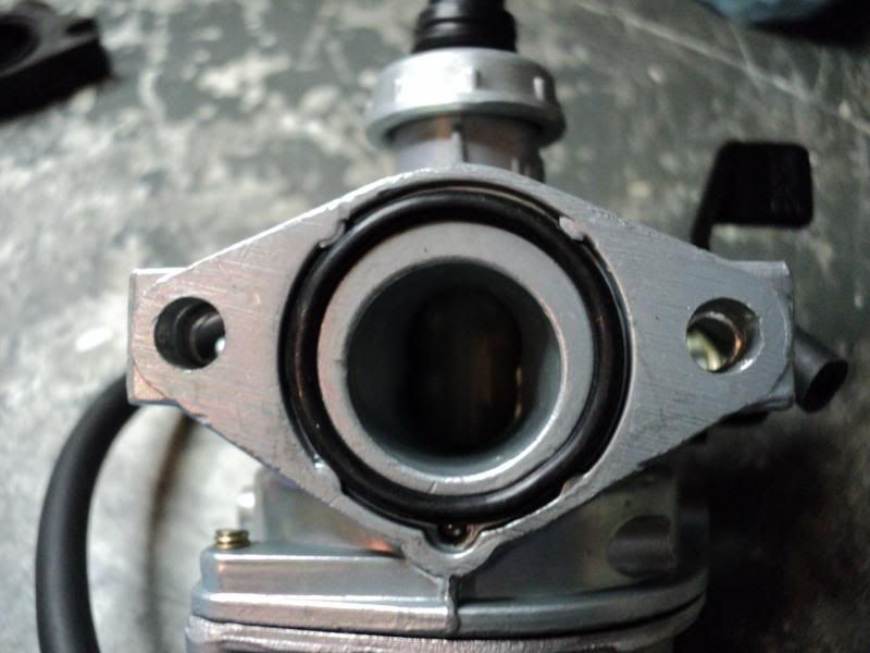

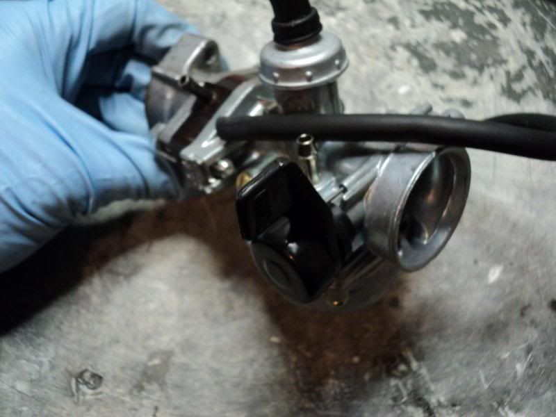

I decided to buy a round slide carb to replace the stock cv carb. It's a pz19 carb that was $20 shipped off ebay. The flange bolts are wider and the opening is 19mm, the stock carb is 18mm.
I got it to run and rev up but haven't road it yet, got the rear tire to spin inside my garage though. I do expect some jets will need changing and messing around with tuning.

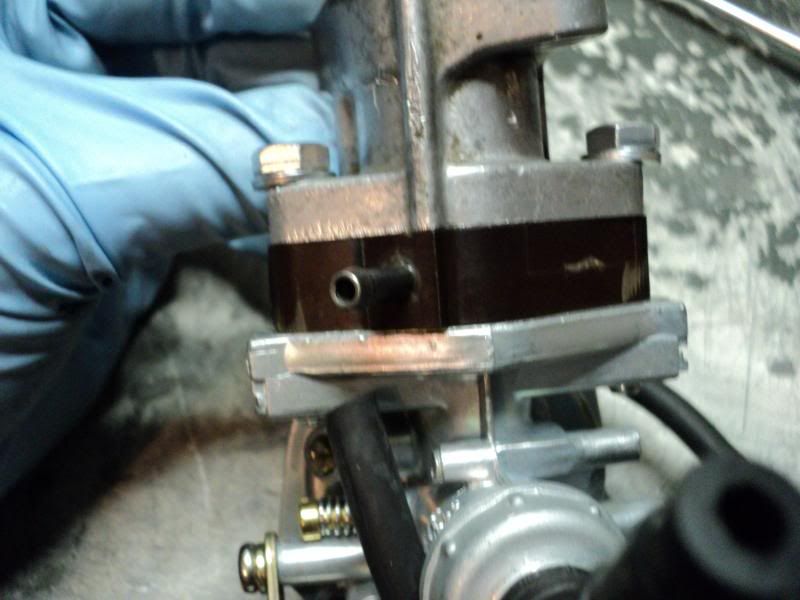

But it's mounted at a weird angle and it's leaking fuel out of the bowl overflow. I'm planning to make a adapter plate or mod the intake manifold to correct this issue before I test ride.

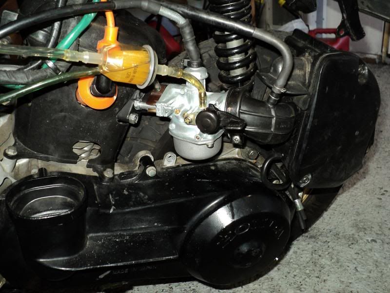

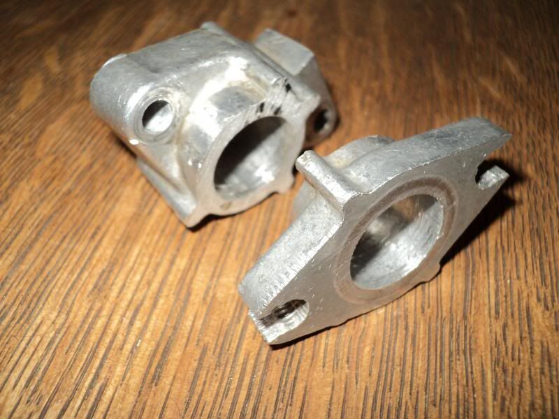

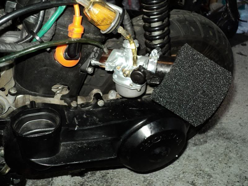

I got the intake manifold welded and the carb is mounted at a correct angle now, not leaking fuel anymore. It actually fit up with the stock snorkel and air box, which doesn't fit under my spree body plastics.
So I'm running a foam filter and working on tuning. The jets that came on the PZ19 carb are unlabeled but I can feel I needed a larger main jet. This carb is sorta a copy of a keihin brand and actually uses the same size main jets as the stock ch80 CV carb. So I swapped in the 88 main, which is the common stock ch80 main jet. Seems to run better on the top end, might even try larger main jets.
Acceleration is great, nice to hit wide open throttle whenever I want. Not like with a CV carb that needs a vacuum diaphragm to raise for WOT.
