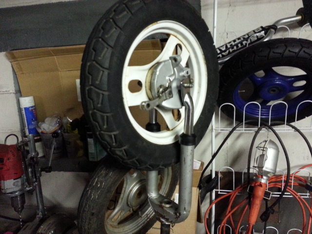

hi forum. here is the photo of the spree forks, elite wheel, and metro hub. it is very close but I think it may work. the shaft from elite and metro have the same width. the metro hub fit the elite wheel. the only mods I may have to do is cut the metro hub about a 1/4 inch. the brake boss has more room to go in. the thinner tire is a 2.50x10. but a 2.75x10 looks like it will work. as you can see I only have about 3/4 inch to work with for both sides. I will need a straight wheel. CAUTION this mod is NOT for everyone. if you want bigger front brakes on your spree. go with the metro front end forks, and wheel swap. you may have to cut into your fairing so they can turn.

I'm just checking if the parts fit.
this looks like it will work. also if I notch the forks a little with a press?

Hi forum. if you plan on using metro front wheel. it will not fit spree fork. too wide.

Does the speedometer work? Wheel rotation is now backwards from its Metro location.
Re: will elite wheel,fit spree front forks,with metro hub br
hi mousewheels. no. the speedo is now backwards. but you can use a GPS, or a free phone app like digiHUD speedo.mousewheels wrote:Thanks for doing this and pics![]()
