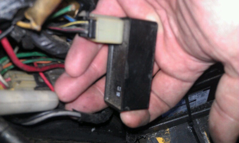

Yes I am very well aware that the final drive reverses the direction. The wheel drives backwards.
I pulled my timing light out and checked timing as it ran backwards with the 85 cdi and the timing looks spot on.
Interesting discovery. I pulled the stock 85 Cdi off and plugged in the cdi that was on the 86 when I got it, (it ran fine with this cdi when I took the engine off my 86 frame.). It doesn't look at all like the 85 cdi. And, it doesn't run well at all. It just sputters a couple times and dies, occasionally backfiring.
The picture is of the cdi that was on the 86 electrics.

Nothing has been done to any thing on the engine since it was on the 86 wiring and running fine.
My next step, I guess, is to put it back on the 86 spree and see if it runs fine or runs backwards. I'm wondering if there has been something odd done to the 86 wiring by the previous owner.
