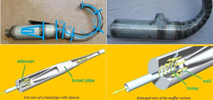

I thought there was a page for pipe measurements on here but I guess it was another site Im a member on. Maybe Wiki would be a good place to do a page for pipes. Theres a ton of knowledge on the rare ones from Sanjuro, tru72, bakaracer, trafficjamz, redeftperformance, graphite9, and a few others who have had pipes imported and still possess them.
This drawing is a good example of what measurements need to be made in addition to the stinger lead pipe and "J" header pipe measurements. Angles are important but its a bit of overkill. If the measurements are off by 5-10% its ok as its human to error.
Re: Burial exhaust from Graphite9
[quote]I thought there was a page for pipe measurements on here but I guess it was another site Im a member on. Maybe Wiki would be a good place to do a page for pipes.[quote]
I'm will create a 'wiki page if folks provide dimensions.
For pipes like the Burial, Scorpion and PG. Does how can we get the tail cone and belly dimensions?
That would be L5, L6 in the diagram LMH posted above. Also, L7 may be an internal stinger from the end of the tailcone to upstream within the pipe.
We need a convention for measuring length of the curved portion of pipe -- middle might be best?
