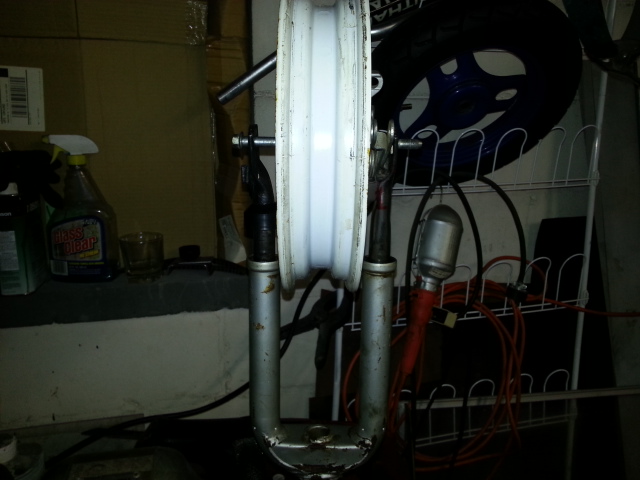

ok. I cut the metro hub, and it did not work.
not what I was hoping for.
The wheel is off to one side and rubs on the spree forks.
I did fine a way to make it work ,but there is a lot of modification.

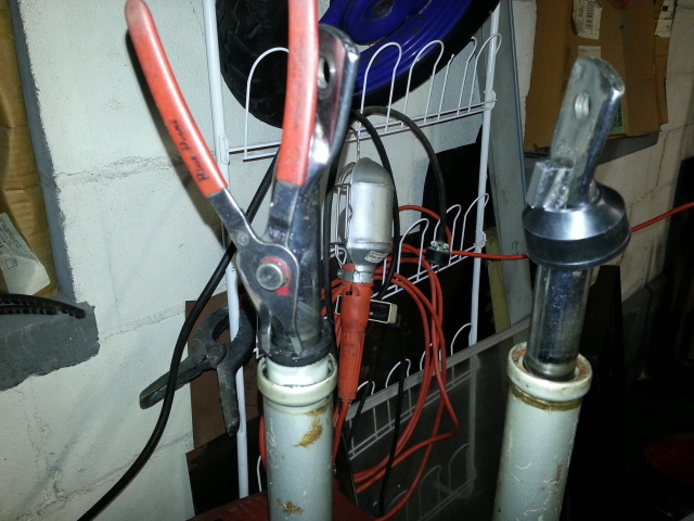

I already started, and will post photos soon. this is where I'm at now. I had to swap the fork tubes. in order to get the wheel centered. I will then have to drill holes on the fork tube. for the new brake boss, and weld it on.

- I had to swap fork tubes.

hi forum. the wheel rubs on the fork tube. I will have to grind down the hub a little to center the wheel.

the wheel is already centered with the hub. I just have to drill forks for the new boss. and weld it in.
as for the speedo I will be using a gps.
