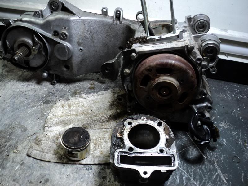

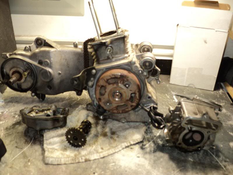

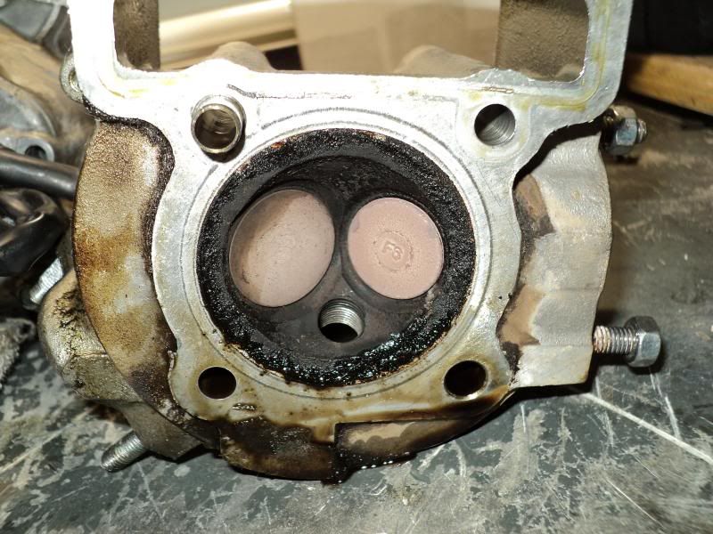

Got the cylinder head off.

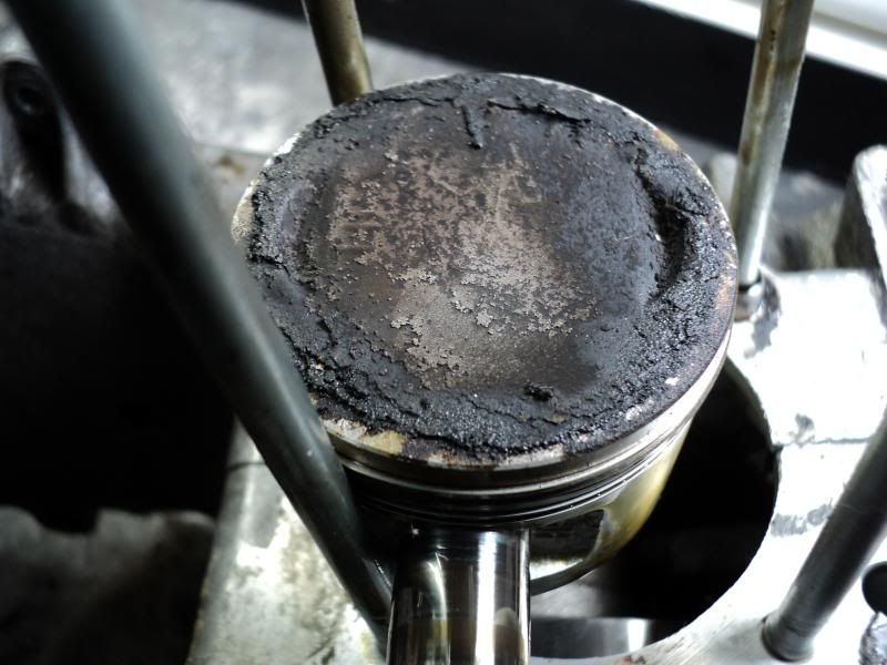

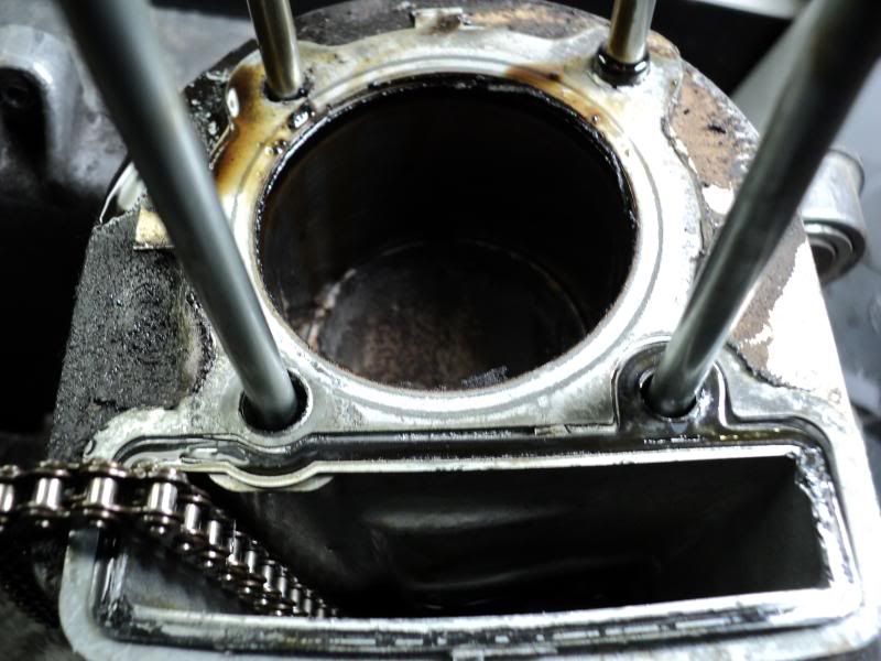

Lots of carbon buildup on the piston and combustion chamber. A few light scrapes on the cylinder walls, I'm hoping to get away with a hone job and a new set of rings. This was a good running engine with around 6k on it but I might as well replace a few parts while I have it taken apart. Everything will need some clean up work for a closer inspection before I start porting.

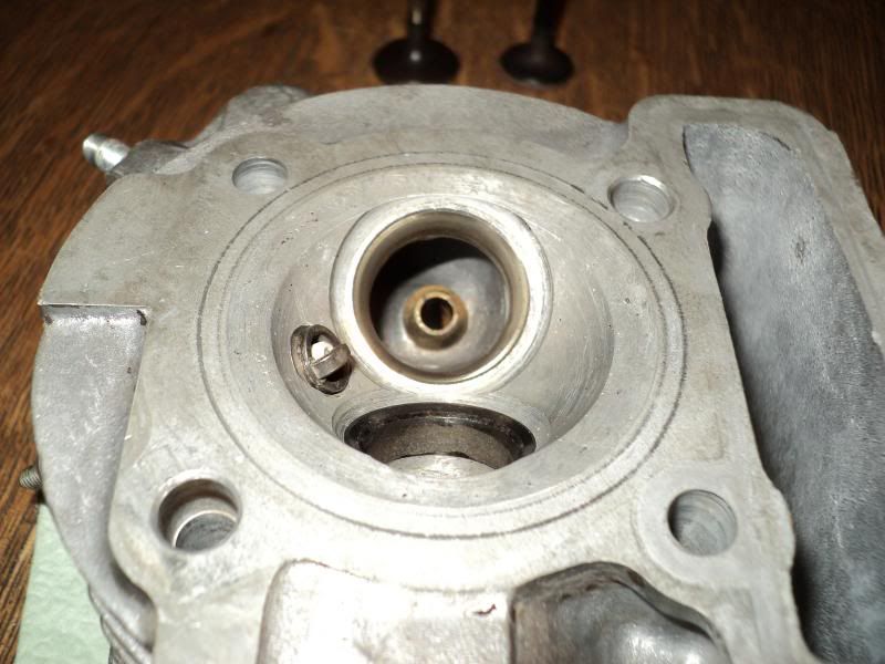

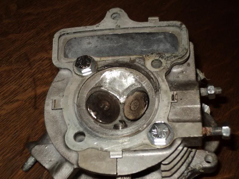

Cleaned up the cylinder head, everything looks good.

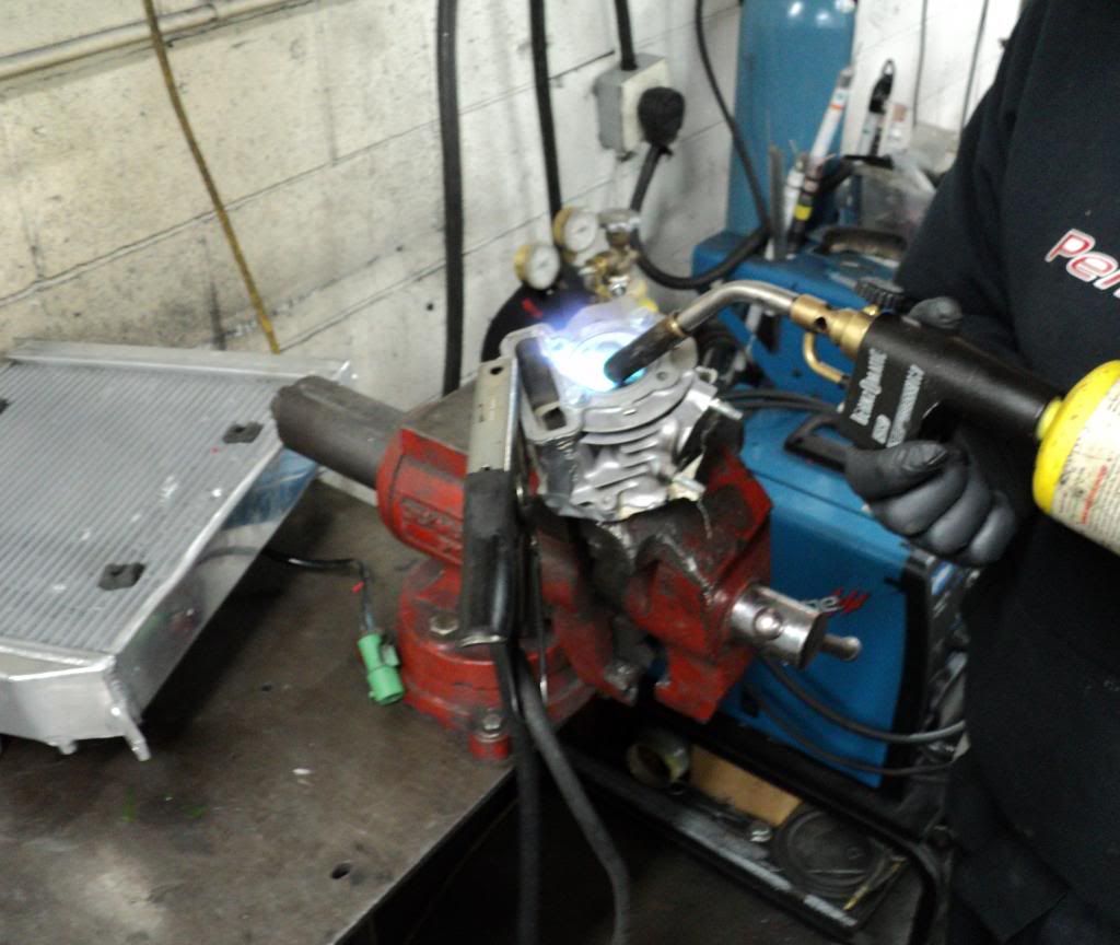

Before I open up the intake and exhaust ports I'm planning on having the combustion chamber "dead space" filled with weld. Just the area across from the spark plug, it's been done on ruckus engines and car cylinder heads. The stock compression of the ch80 is 9.3:1 according to the service manual. This mod should raise the compression and make the combustion chamber more efficient. I've also been looking into other combustion chamber mods like the Somender Singh grooves that could improve performance.

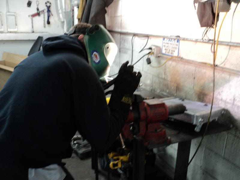

My brother is doing the fill weld for me, he's a pretty good TIG welder. I bolted the old head gasket on and set the valves in place to protect the surfaces and valve seats. Heating it up first with a torch makes the weld penetrate easier and burns off any impurities.

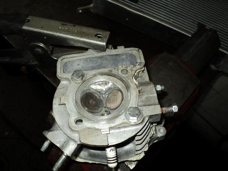

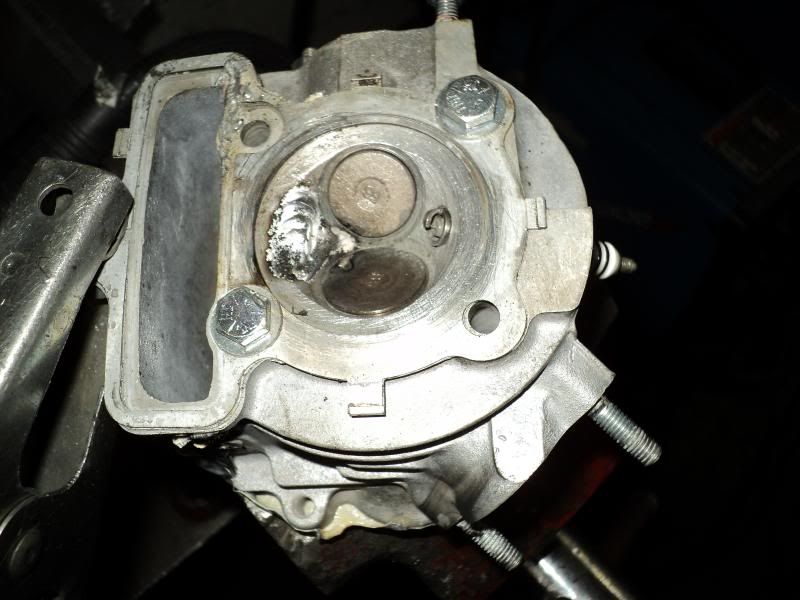

Midway through welding, a little issue with the TIG arc jumping to the valves. Looks like I'm going to need new valves but I'm glad the seats are fine.

Welding is done, went just up to the dome ridge. I've seen people weld higher up to the gasket surface and then have the head resurfaced, but I'm not going that far.

Did some grinding, it will need a bit more work. I'll probably do the somender singh grooves too.

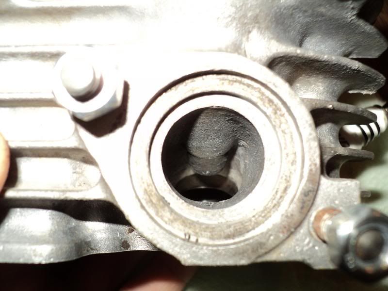

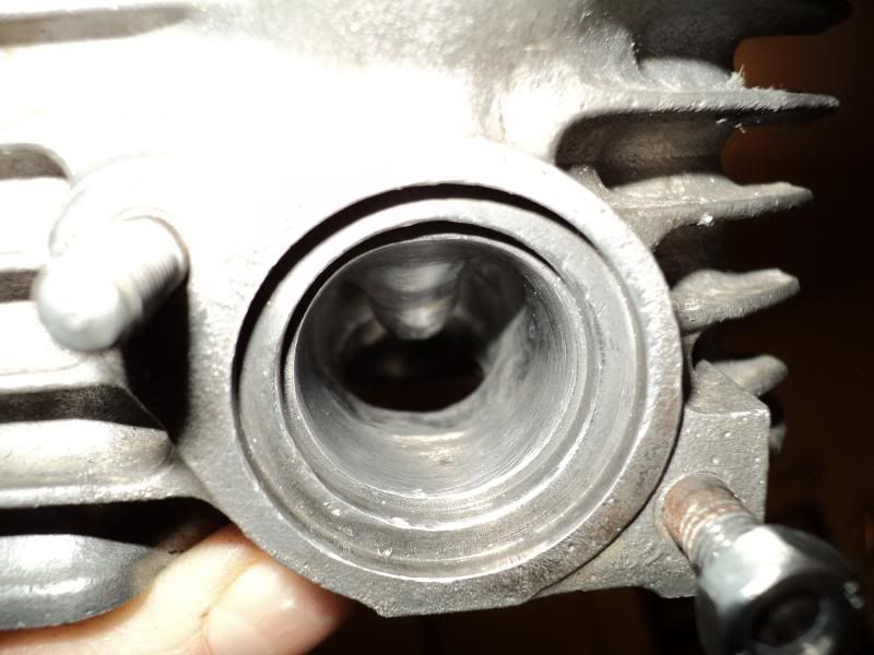

Here's the exhaust port before and after opening it up.
