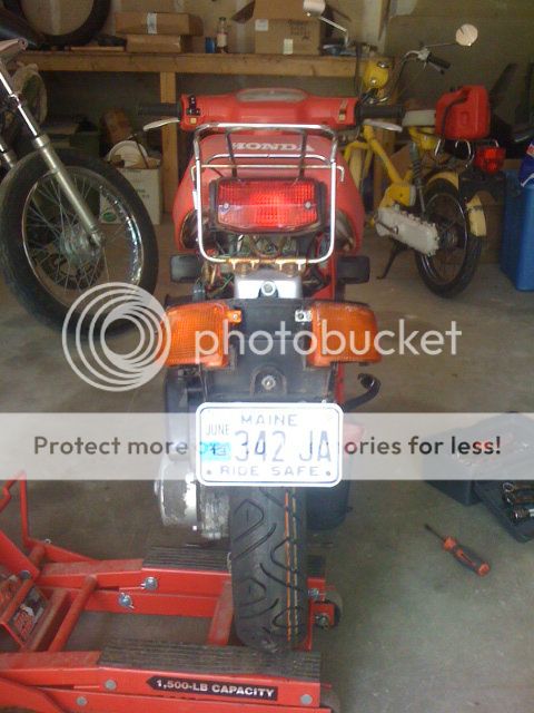

Nice aero, i have a set of rare brand new mallossi gears for your engine, pm me if you are interested.
