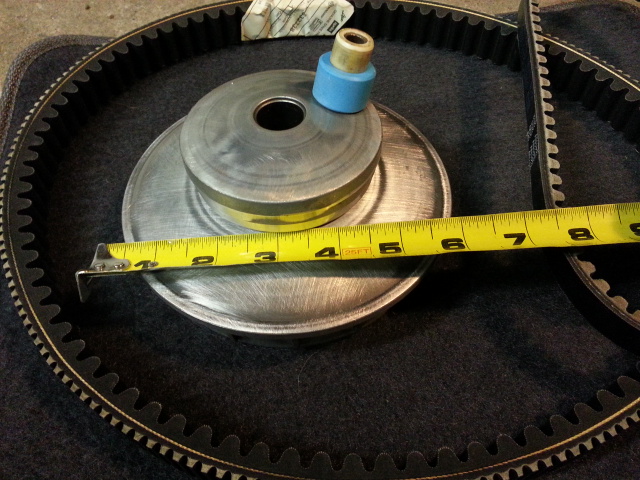

I was changing my belt on my piaggio and decided to do a variator size comparison.
I have a stock piaggio 500 ,and a stock Elite 50 variator. take a look at the size difference.
small photo size due too camera phone.
Piaggio 500 vs Elite 50 variator size comparison
- notice the pulley in the center
- 20140420_003203[1].jpg (181.05 KiB) Viewed 13034 times
- 20140420_040638[1].jpg (158.31 KiB) Viewed 13034 times
- can you see the rollers
- 20140420_040903[2].jpg (165.49 KiB) Viewed 13034 times

Re: Piaggio 500 vs Elite 50 variator size comparison
Thanks ped.
Wear marks on your Piaggio show min dia is about our scooters max:lol: Calculation of belt speed shows almost 90mph at 5500rpm. Our 50cc/3" pulley needs a bit over 10k to hit 90.
hi mousewheels.
the cover has a vent in the rear. what's interesting is that it has a filter in the front ,and the center. but no filter out the exhaust side. you can see the rear pulley. I guess the air blows all the dust out the rear. no filter needed in the rear with the fan blowing filtered air through.
