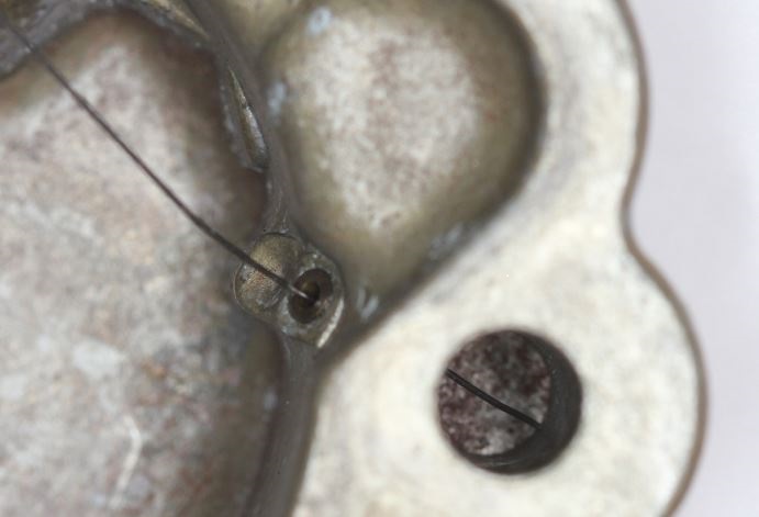

1) A clogged passage between the main carb bowl, and the tube directly underneath the Bystarter. It's approx. 0.75" on the scale on the pic below

NO! I saw that, but thought it was a "roll pin" as it didn't look like a passage way, I am sure that is the problem. Thanks......

That picture that mousewheels provided is great, that orifice shown is almost always clogged. The scooter will be extremely hard ( if not impossible) to start when that tiny hole is clogged.
If it is open, you can shine a penlight through it , or you can spray carb cleaner through it. Either way, it must be open.

:) The pic shows 0.75" as a measurement from bottom of bowl, to approx. the orifice location.
If worse comes to worse, maybe I will try to drill it out to .75mm (as a last resort).
The passage is used as a metering jet. 0.75mm will be rich when cold. Around 0.33mm is close. I have roughly sized the orifice to 0.013" using wire gauges in 0.001" increments.
-- Orifice
A 0.010" wire was used in the pic. Try a straightened strand from a bicycle shift cable or the smallest guitar string.
