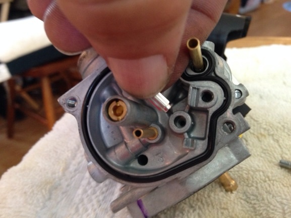

Does the little thing in my fingers go in the hole where I have it pointing? That's right under the float and that's where I had it before. The float is notched for it to go in it. At least it looks like it.

- Posts: 3487
Re: Gotta love Carbs!
> The pink tub on the left is leaking gas.
That is the bowl drain tube. Check that the screw in the bottom of the bowl is closed, and clean the carb bowl if needed.
Yes - that is the float valve. Check it's rubber tip for wear and the seat in carb body for squeaky clean.
