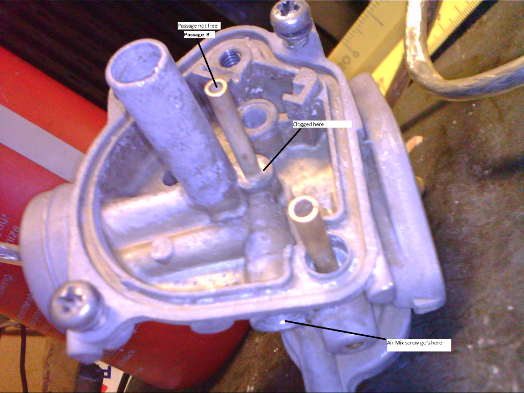

Well I am pretty sure I have all the small passageways cleaned out but one. After soaking in carb dip for 3 days, blowing them all out with compressed air, and re soaking again in Acetone over night. I have one passageway that so far has resisted clean out. I even poked and prodded with a .014 music wire to no avail.

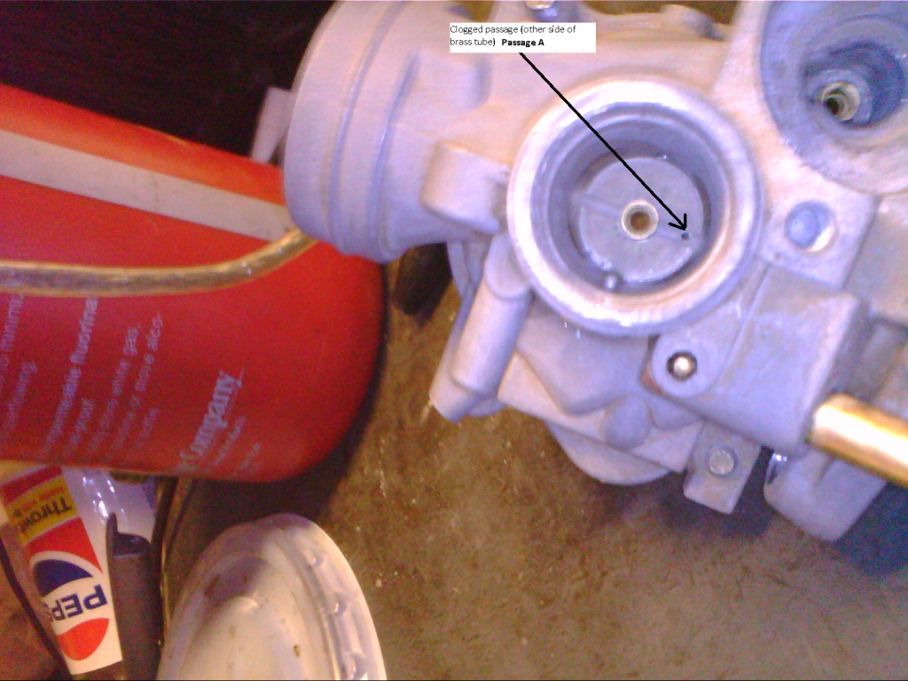

It is the tiny passage from air mix screw>brass pickup tube in bowel>tiny exit hole in high velocity part of carb (I can remove the air mix screw completely with no change in the way it runs. I think it is clear going from air mix screw and exit point in neck of carb, but the brass pick up tube part of the "T" passages (to fuel bowel) is still plugged (I put a vacuum gauge on it and after creating a vacuum, the vacuum holds steady).
I am going to let if soak for several days in Acetone, any suggestions?
Oh yeah... this is on a 1985 Honda Spree 50cc
Is there supposed to be a clear passage between passage A and brass tube B? When I apply a vacuum at brass tube B it will hold a vacuum with no leakage shown on the vacuum gauge (so its clogged I assume)

You are lucky sprees are so common where you are, I have two sprees and have only seen three others and they were online for sale, one close to me and two were in another provinvce 500 miles away or more.as for that passage in the float bowl that feeds the pilot circuit. You can get them clear it can just take a long time. My express carb took over two hours to get clear. Poke a little, then spray with carb cleaner let it soak a bit then scrape and poke some more. A tiny numbered drill set could really be a help as well as a set of welding tip cleaners.

Thank you everyone for your responses, especially mousewheels for the pictures he sent me. The clog up was inside a super tiny passage near the bottom of brass tube A.
