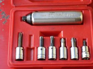

Post by Johnniespeed »
impact driver.jpg (13.32 KiB) Viewed 10358 times
The impact driver that was suggested, is the type that you select a bit type, Phillips #3 probably, put it on the driver, place it into the screw, twist slightly with your hand then hit the end with a hammer.
A pneumatic impact was not the suggestion.

Many thanks to all, you guys are the best....
Found the impact kit this morning at Advanced Auto - $9.99...
came out in less than a few minutes....
happy hippy happy.... and have a new toy for neighbors to borrow!
