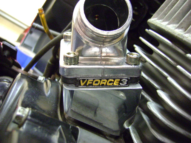

I do have one technical question:
On the 2nd pic from the bottom (viewing the inlet side of the reed valve) it appears like the ct mani that bolts up to that will have a large reduction in flow because the small diameter of that vf inlet. Is this correct or I am seeing things? If so, Perhaps creating some transitional insert would be in order to help things a bit.

all kidding aside i did need to drill out the holes on the manifold where it mounts to the block and also the holes on the reed block because i could only get 3 bolt holes lined up, its not very difficult but just saying :)

The KX65 reed block fits the CT manifold, pics included to prove it. Of course aftermarket stuff requires a little fitting and filing, everyone knows that.
The guy is probably smarter than he sounds and just trying to stir up an argument.
But yet he cant afford $130 and wants a cheaper way out, here is a hint, the CT manifold comes with a cheap reed block, just use that.
