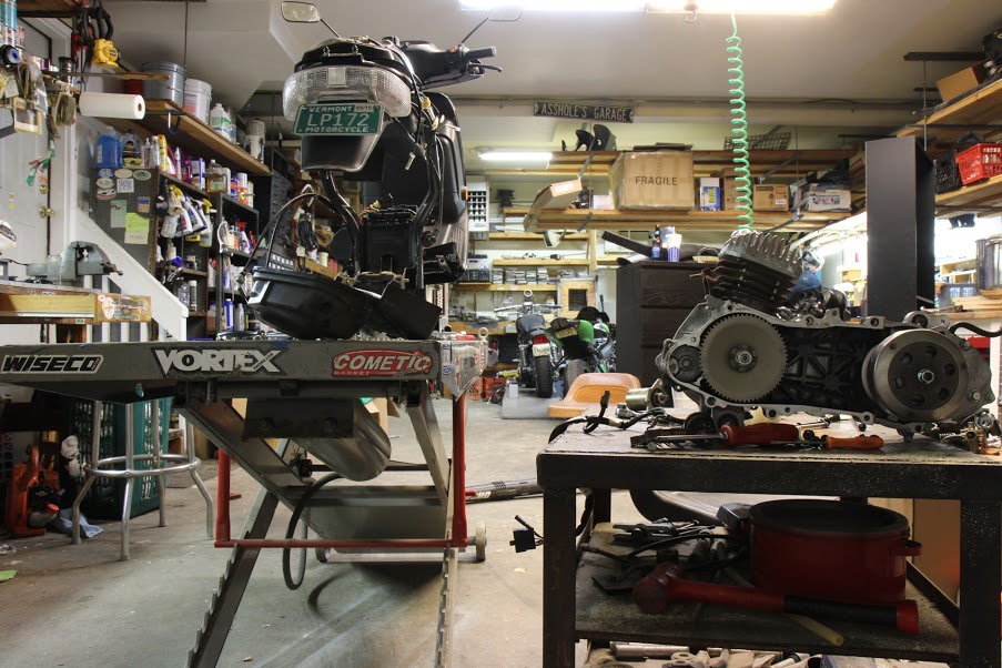

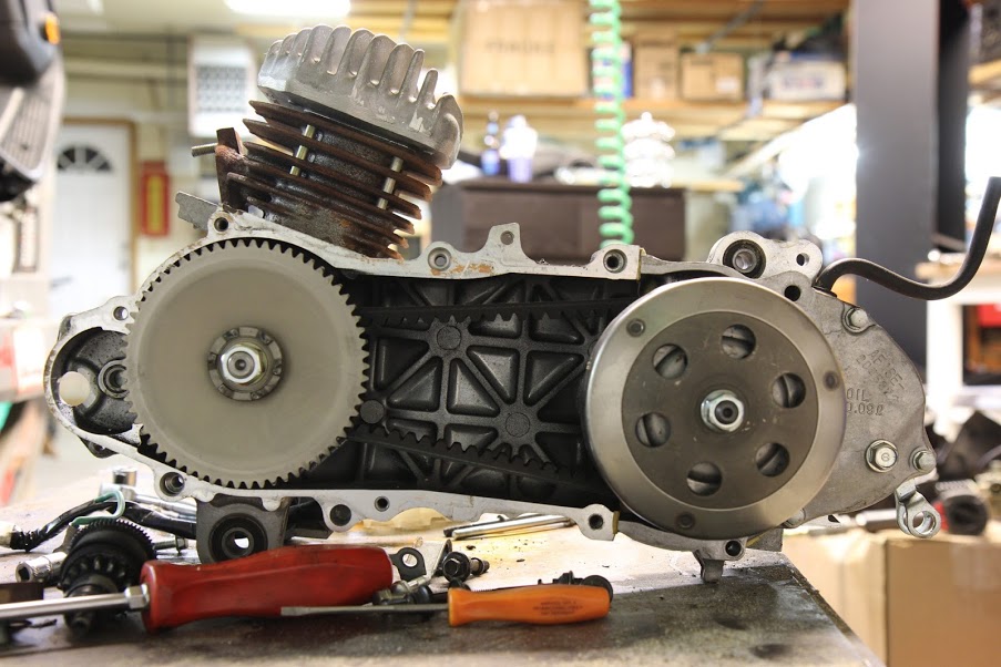

these are a few pics of what ive done thus far
paulpauly7
Posts: 1684
Location: nz
Re: Tattoli 72cc af16 builde
Post by paulpauly7 »
i like the sign hanging from the roof

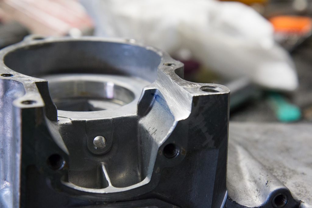

well its all done now, it runs ok still need to dial in the trans tuning i think. pulls really hard from around 10 mph up to 55, the ruckus variator seems to be pulling the belt up on the drive face without additional spacers between the drive face and variator boss. here are some photos of the porting i did(first time using a die grinder haha) and some of the scooter after completion.
sorry for lack of updates and poor photos, everything was a lot more disorganised than i was hoping it would be... to say the least :lol:
for anyone that reads this in the future and wants it to go as smoothly as possible get a service manual, flywheel puller, steering wheel puller to split the cases, and a crank puller for installing the new crank :))))) that was the biggest hurdle for me having never split crank cases before
