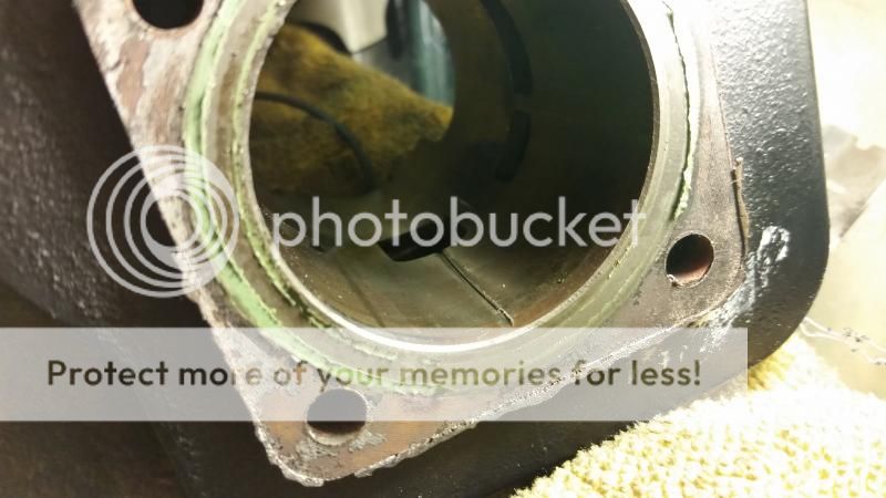

Found out what my problem was. Thetes a scratch on my cyclinder and piston and the top piston ring was stuck where the line was. Bottom ring was okay though. I free'd the top ring and used a piece of sandpaper to open up where it got stuck in to ensure that the ring moves freely and now it seems fine. I was gonna try to put it back together but it was getting late and I didn't have my honda bond cause a friend borrowed it a few days ago but I'm going to pick it up from him after I finish work. Do you think it's still runnable?

Found out what my problem was. There's a scratch on my cyclinder and piston and the top piston ring was stuck where the scratch was. Bottom ring was okay though. I free'd the top ring and used a piece of sandpaper to open up where it got stuck in to ensure that the ring moves freely and now it seems fine. I was gonna try to put it back together but it was getting late and I didn't have my honda bond cause a friend borrowed it a few days ago but I'm going to pick it up from him after I finish work. Do you think it's still runnable?

It looks to me like something got sucked up into the cylinder through the transfer port and hung on to the side of the piston on the way up. You better find out what it was. You can't run that like it is.
Needs a re-bore and new parts.
Re: Bike won't start after oil plug comming off while riding
What are you HondaBonding?
I recommend you find what ever caused that scratch.
If you put it back together as is with a little lube oil, it should start and run for at least several minutes.

Yeah I'm gonna clean out the block. I use honda bond to reseal when I reassemble the bore.

You probably sucked something up when the plug came undone. That's so unfortunate but at least you figured it out quick!

That's a gouge from a foreign body right there. There is a nice ding or two in the top of that piston. Even if you honed that up a bunch you will have basically no compression. For what you would pay to fix that cylinder I bet a new top end would be the right fix. I would be digging around in that crank case to find what ever did that. Maybe vacuum it all out.
