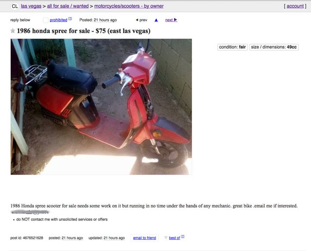

Like always checked craigslist and saw an ad with no ph # and only email reply .
The ad was up for 21 hours thats a long time for a Spree ad at a low price .

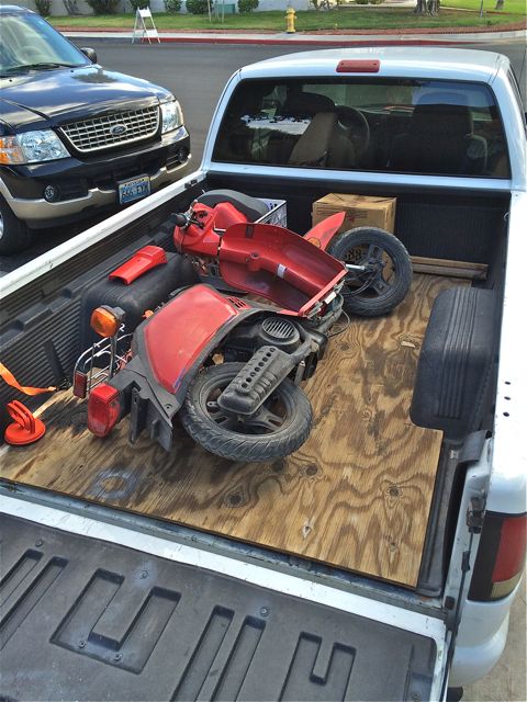

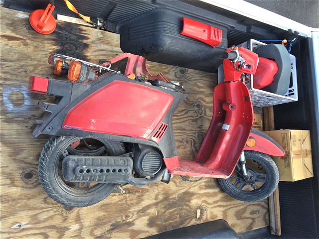

Well the seller called back right after I sent the email got his address and was on my way ....
Saw the Spree and it looked rough but I knew I had all the parts at my place never throw any Spree parts away ever .
I have had so many Sprees do I really need another one ?
He was asking $75 but I said can I make you an offer ? How about $40 bucks I was almost hoping he would say no
but he said yes .
And so the story begins ....

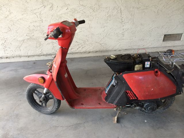

I have learned the hard way first thing is get the bike running ,never put a lot of time into a project then find out the motor is shot .
OK put some gas in messed with wiring no key (of course ) used a screwdriver to turn ignition switch on ..
sprayed in some starting fluid hooked up a battery ....
Tried stater click click kick start nope .... nope ...... nope .....
sputter ... nope ....kick again sputter sput sput /Thats a good sign
don't give up ....
Hock up battery started up rrrrrrrrrrrrrrrr....rrrrrrrrrrrrrrrrr kick rrrrrrrrrrrrrrrrrrwaaaaaaaaaaaaaaaaaaAAAAAAAAAAAAAAAAAAAh
Ok good sign it runs ....
Next cut the bailing wire & zip ties holding the plastics on ........
The frame is painted tweeker blue in spots the front fender and side panels look like bed liner paint ...no problem ....

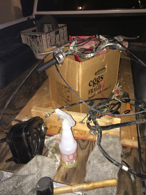

Started stripping the Spree down weird bolts different size bolts more bailing wire holding things together .
Funky looking carb might be from a Aero more zip ties ...
Went and got Spree parts from shed .

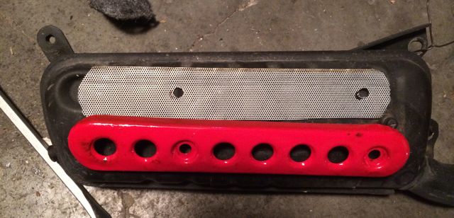

The muffler had a tweek in it so I used one I had sitting around put some grill behind the cover who knows
maybe it will go faster ?

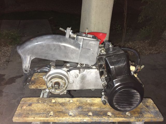

Started to pull the engine
Re: $40.00 SPREE Build ( Thanks Crigslist )
Heres what the pipe looked like after I put the grill in . Started stripping some paint and cleaning the engine

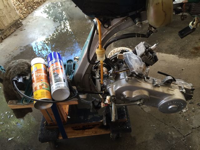

OK started cleaning engine put a cork in the head and covered the carb with plastic so no water damage .
Big decision time should I pull the engine and give it a good clean ?

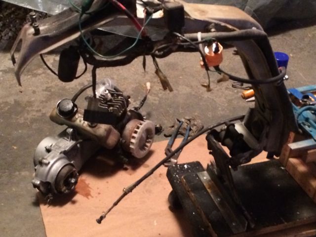

OK engine off ... Now another question do I strip it down to the frame ?
Never try to take off the front fender the forks have to be removed and it's a real pain in the asset .

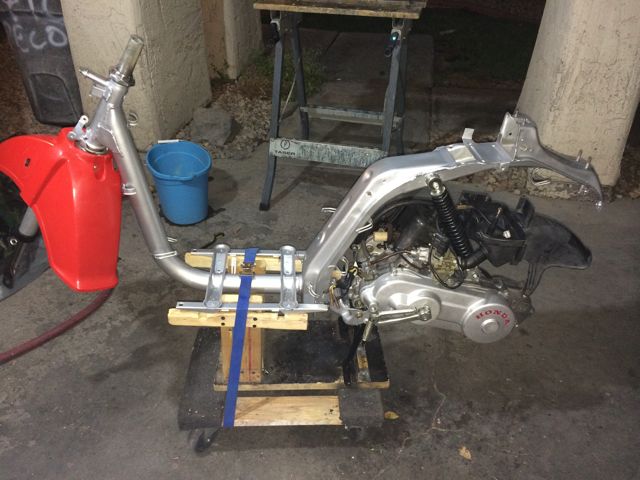

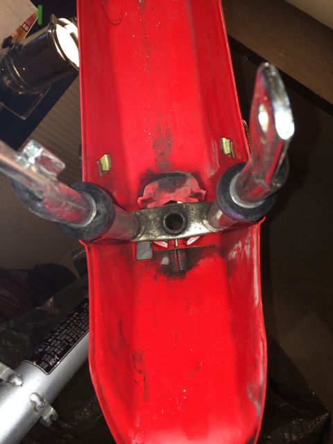

Got as much as the guuck off the frame
Cleaned the inside of the front fender ...
Well that was enough for 1 day / night .
Box of parts and a frame left ....

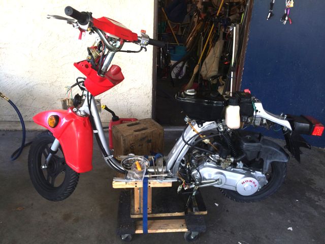

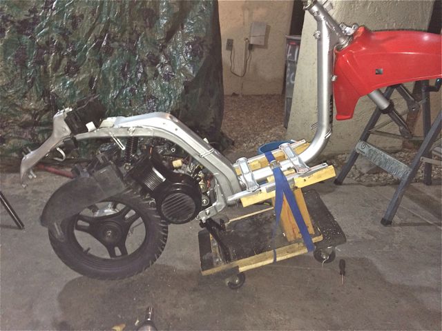

Shine engine that runs ...
Stick back on frame thats dried.

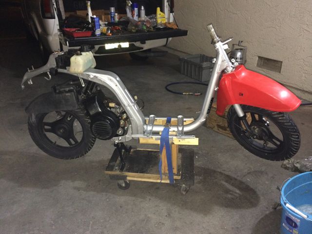

Stick on rear wheel ...
Day has now become night .

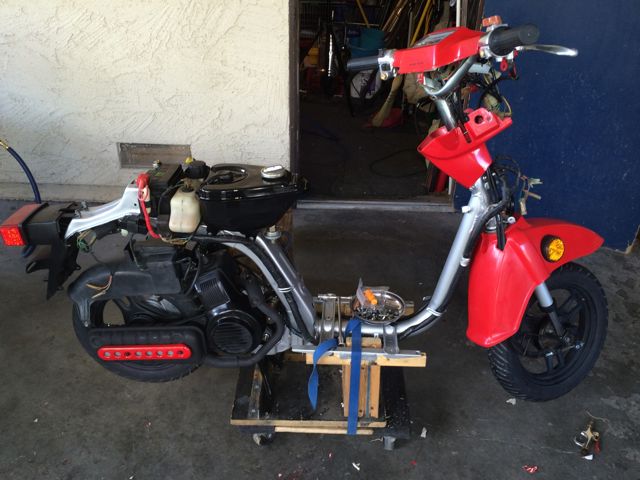

Stick front wheel on starting to look like a scoot .
Noticed mileage on speedo 26662 Thats a good sign two 66six too .
I,m feeling a lot better about this bike .
Well it,s night time again pack it in more sheet tomorrow

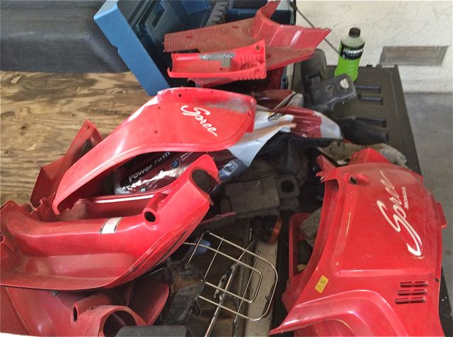

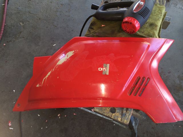

Start on plastics from another Spree
Scrape off old decals quick sand ...paint ...

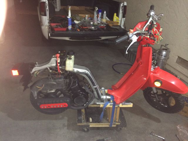

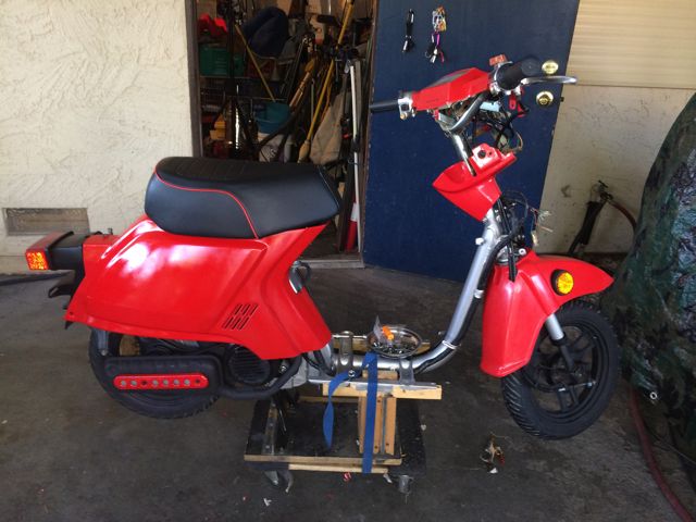

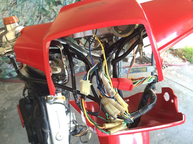

Start putting on gas tank oil tank front handle bars and headlight plastics some electric .
Tried on plastics side cover ...
Put on Spree decal a bud had made for me ...
Wasn't sure about black Spree decal but once I put it on looked great .
