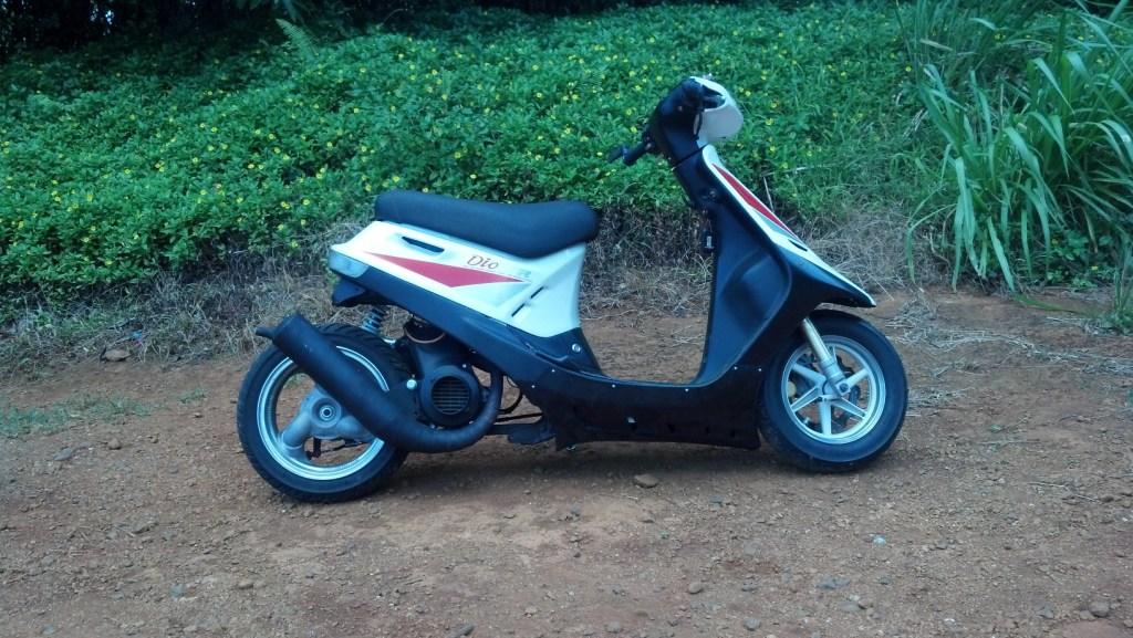

Here is how the bike looks now. I'll look for old pics later.
BMX clamp, drag bar, NCY stem, RRGS drop legs, 220mm koso rotor, rpm quick throttle, dd50 rim, small spree front tire, 3" stretch, ruckus rear rim, 90/90 tire. I've ran the ruck rear rim many times before without problems

Post by kauaianman »
here's mines
