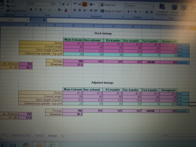

I should've just randomly thrown this together the first time, but by raising my exhaust 1mm my timing goes to 186 for the exhaust. Ill measure out 1mm and cut as straight as I can. Ill only cut maybe .8 of the mm and use the other .2 for chamfering. These are rough numbers cuz my hand isnt skilled enough to cut in tenths of millimeters, but just so you understand, im not cutting the full mm.
as you can see this will increase my blowdown, narrowing my powerband but increasing power output in the powerband.
now, bram chose my timings for me according to the c16 specifications. I will have to see rpm he is identifying with the c16. i think i can do that just by looking at these adjusted timings.

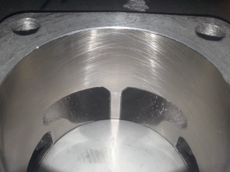

What a challenge. ~1mm raised. Mostly even. Measures 23mm to the top of the barrel so im in that 186 degree area. This is a pic of 1 side raised roughly 1mm..

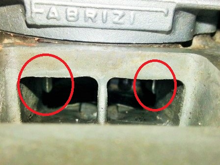

I cut back the skirt of the cylinder on the intake as well. Just thought I'd share. My before picture sucks. But when I trimmed back the walls of the intake track there was cylinder skirt blocking flow in the front and rear. This area is the only place I skid my dremel across the nikasil. Hopefully a skid on the inside of the cylinder skirt isnt too big a deal.

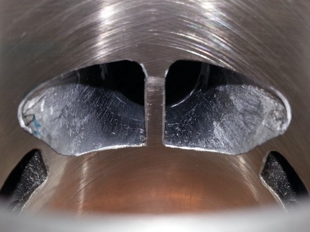

More pics. Just need to bevel and polish. I give a lot of props to malossi. I was over at Whiteys house the other night, and the malossi casting is by far superior to that of fabrizi. This is my first real porting job where I am setting the timing. I'm glad my "advisor" suggested that I leave the transfers alone.

Clues at the scene of the crime. Now I must leave this behind for a week of sun bathing and swimming in the Carribean.

Btw, I showed my wife these last two pics to let her know what I've been doing in the basement. She says, "oh you made it shiny?". No hunny, I changed the shape.

did you remove 1mm from exhaust per the computer program or just advise?DirtyE wrote:More pics. Just need to bevel and polish. I give a lot of props to malossi. I was over at Whiteys house the other night, and the malossi casting is by far superior to that of fabrizi. This is my first real porting job where I am setting the timing. I'm glad my "advisor" suggested that I leave the transfers alone.
wondering what that porting program says about making more power at the higher rev range. i'm assuming Fabrizi can make power at 11k right out of the box. interested to see what that programs says about making more power with that cylinder.
nice port job.
Re: Dear Diary: Fabrizi 50mm bore portmap/Port timings
I did it per the spreadsheet and advice. I put numbers in the spreadsheet for squish, conrod, stroke...... and it tells me what the timing is. I consulted with bram about finding a good timing for exhaust to match the c16. Earlier in this thread I posted a link to his blog which provides information about exhaust port timing related to rpm, transfer port timing and the corresponding blowdown. It then explains about wide and narrow powerbands and how they relate to how your port timing is setup.
