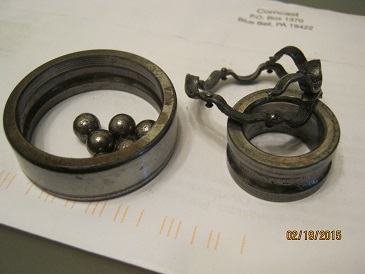

Pulled out the engine and tore it down. Used the kitchen table, which is one of the perks of not having a gf. ;) Main bearing was shot; the cage in the bearing was only holding 2 of the 7 balls in place.

The other balls were running freely between the two races. Crank has play in it. Replaced only the bearing and reused everything else. Crank spun smoothly after the replacement.

Oh, and here is what is left of the bearing.
