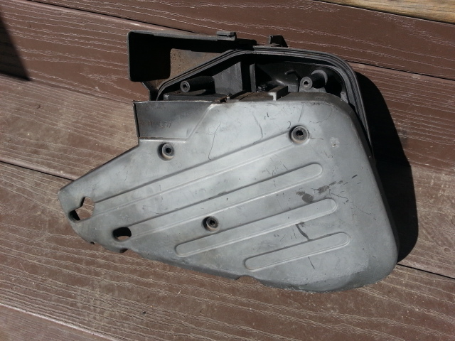

First thing I'll do is a compression check to see if that's the problem. I haven't really even had time to look at it. Can someone post the air box and lid picture to see what it is suppose to look like. Want to make sure I have the right one.
Re: 2001 Elite S 50 performance
- 20150312_134927.jpg (156.35 KiB) Viewed 11053 times
