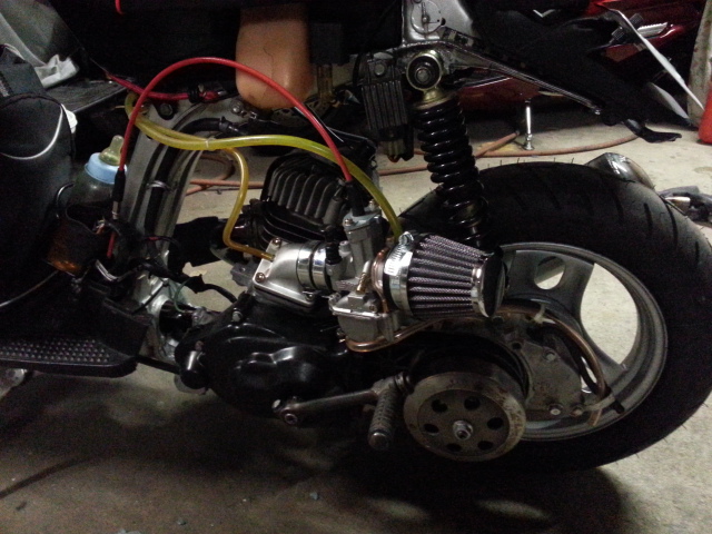

hi forum.
I'm going to install the motor on the spree for tuning purposes.
I don't use the panels and won't have to pull the seat :smile:

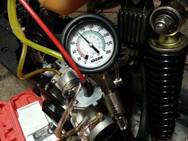

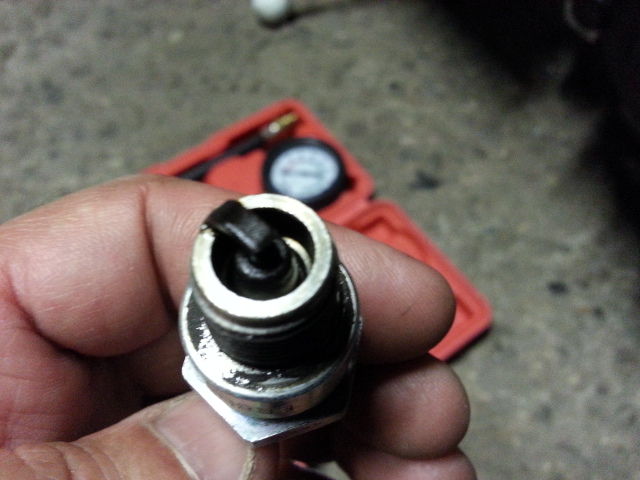

plug seems a little Oily. :?
compression is at 130 psi. :smile:
going through some heat cycles. :nerd:

If your plug is shiny black around the threaded area or at the ring it usually means you're too rich on the pilot, if it's shiny black everywhere, on the resistor tip, the arm, and the threads it means too rich all around and you will be building up hard carbon deposits. Being a tad rich is ok for break in, being too rich during break in and you can leave deposits on the piston, head, and ex port which can scratch up the bore and piston later.
Believe me I know it's a pain.

Xxbeejay45xx wrote:Nice its up and running! :popcorn:
hi forum. motor is running. :smile:
doing some heat cycles and still tuning when I have the time. lol. :thumbwink:
here's a video of it running. https://www.youtube.com/watch?v=T8iRE50 ... e=youtu.be

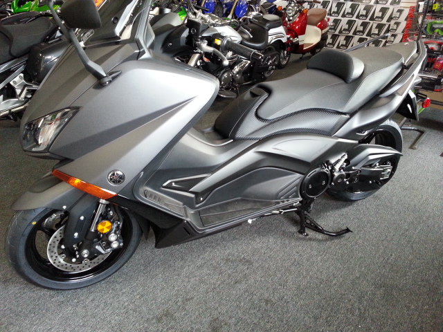

The Yamaha dealer had this Tmax 530 I think they wanted 10.500 for it. it looks cool. :shock:
Oop's sorry about the photo. ill see if I take another. : )
