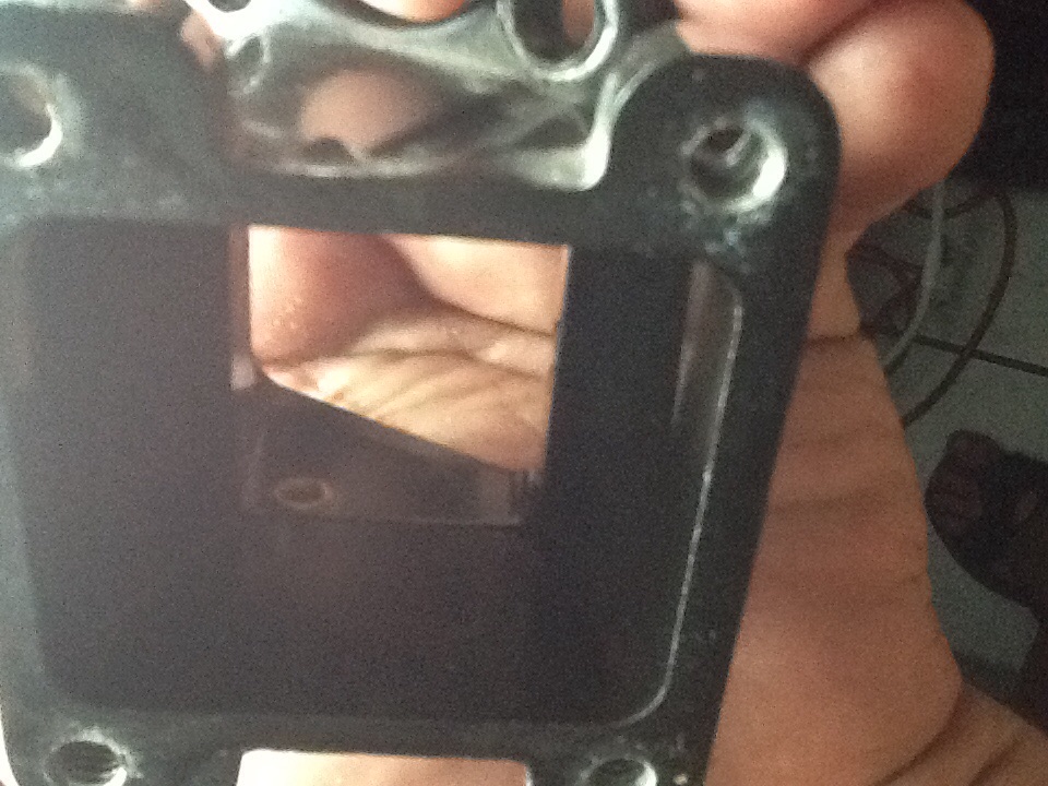

- Trafficjamz
- Posts: 5013
- Location: Eastlake, MI
Re: Finally getting an authentic super dio!
1man8scoots wrote:Use your nip from the manifold just like you would a normal vacuum style petcock.
Looks sweet!
I'm not sure that will work/
fuel pump needs to be hooked to the case after the reeds not before.
Pretty sure you can just move the nipple to the bottom half of the intake and seal the original hole, that way it is below the reeds. Pretty sure that's what downsouthdio did on his.
Yap the reason why fuel pump vaccum fail.. need to tap below the reed valve on buttom intake manifold.
The af16 block don't have a brass fitting below the starter.
Yes on gavaity fuel tank , you can on oil pump plug add a nipple or stock oil pump , remove the shaft. Need a rubber cap on Oil line.
1man8scoots
- Posts: 1119
- Location: usa
Oops, they are correct. Ha I must have been sleepy. Extra work on top of everything I need to slow down and read what I write before giving poor advice.
- Downsouthdio
- Posts: 835
- Location: Key west
Like so
- image.jpg (207.59 KiB) Viewed 12490 times
