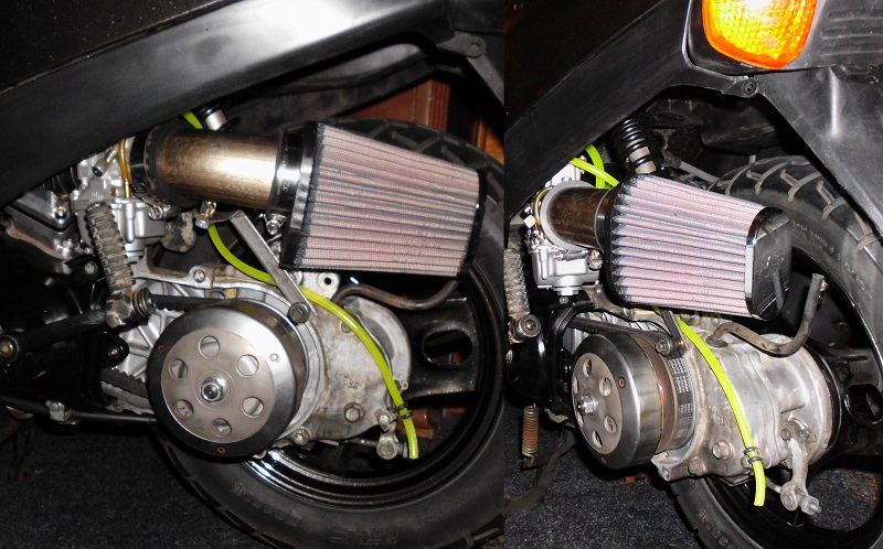

had a old air filter for my motorcycle
so I came up with this ( this is a proto type some mods will be made)
I wanted it to fit under the side skirt
2.0 piece of exhaust 2.0 hose 6mm coupling nut brazed to the exhaust
and some 1/8 x 1/2 steel for support
this is what I came up with

hi cruz. nice work. like the tape and vac trick. :wink:
