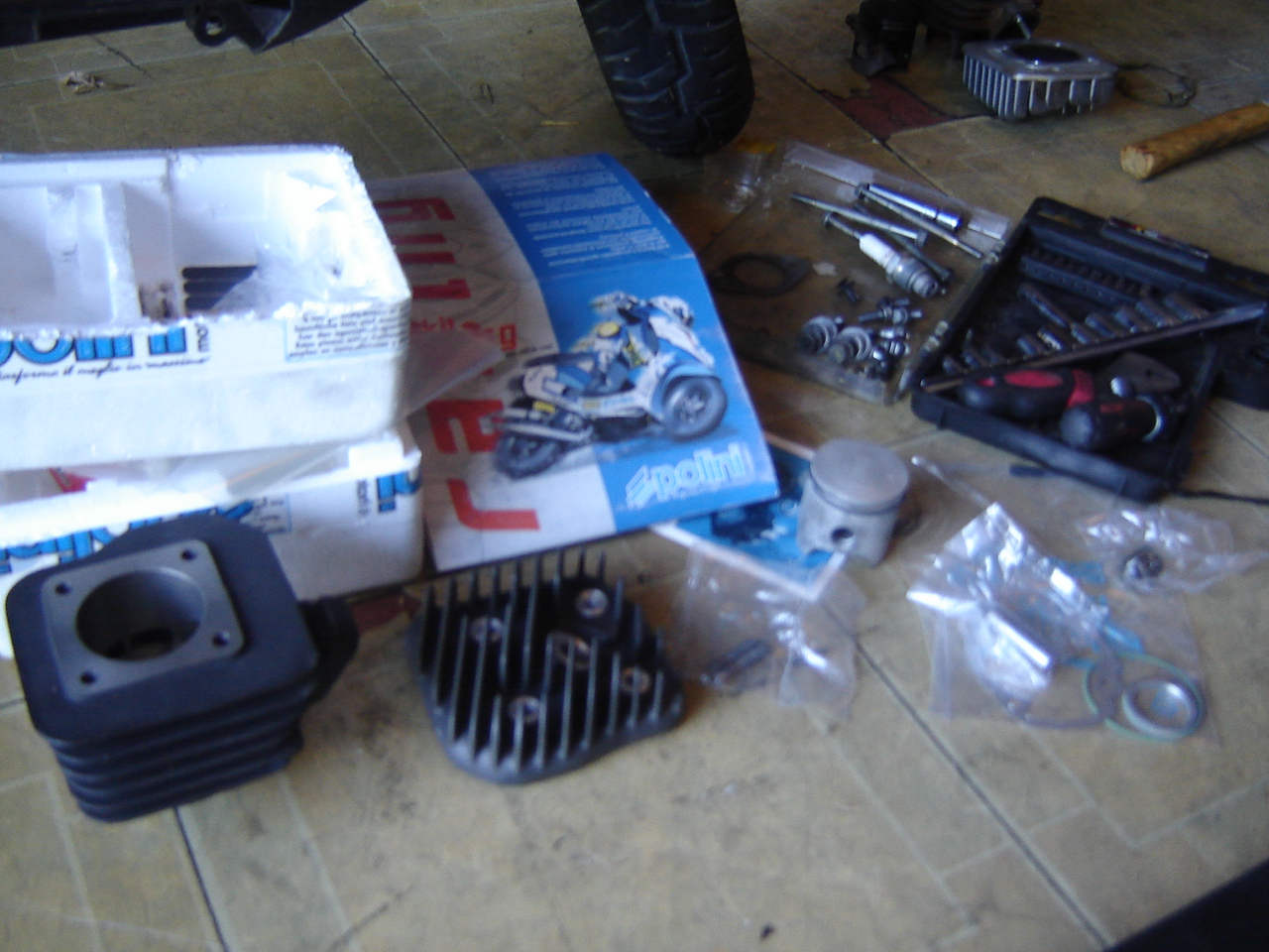

wow so LONG time no update. (note the year on last post woah..) after a long dry spell of no scooter modding to speak off, I'm finally back at it. with hopefully better results than each last time I tried.. chalk it up to health issues and a pretty serious motorcycle accident :cry: but we don't need to talk about that.
enough about the sad stuff and onto the new and better!! Bee is now rocking new panels. got tired of the yellow and stickers and had a spare black 01 SR with mild mods that I ended up selling, and swapped the black SR panels for that all black on black look. Loving it lots.
YMS pipe started crapping out, after MANY MANY miles of solid use (5k+ easily), so I FINALLY went ahead and added the Scorpion pipe that's been on the shelf for quite literally almost "years" by this point. HOly moly it fckn rips. And looks awesome to boot, plus gotta love that dirtbike sound. still dialing in, but it certainly wakes up a Corsa
More mods and tuning to come for sure on the way. Here's some pre-pipe and pre-panel swap pics for now. peace :hi:
