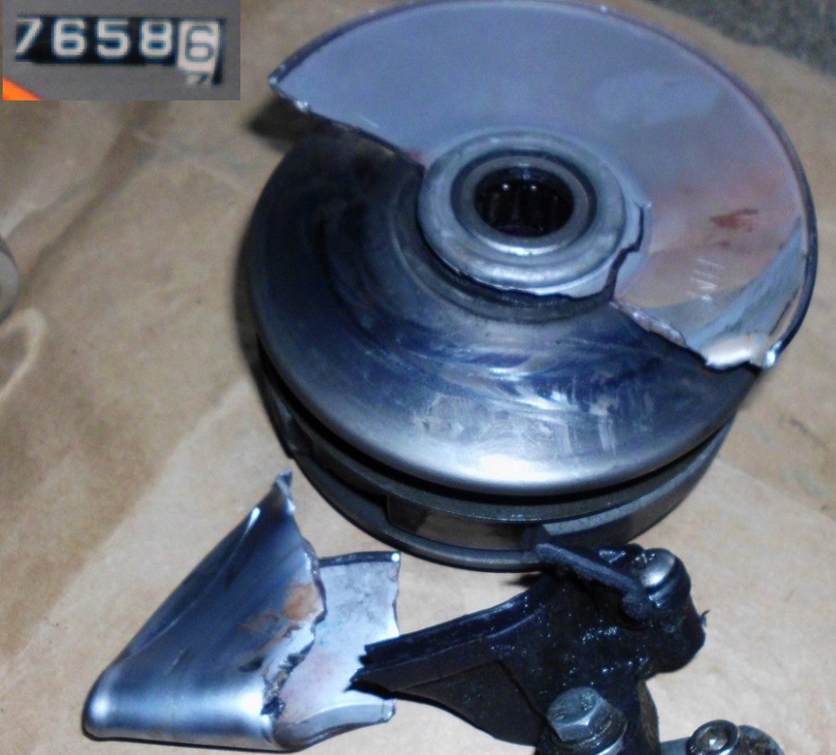

just a heads up
I would check your rear drive face for cracks ?
at least I wasn't far from home
doing 35 40 mph ish
locked the rear wheel up for a split second
repaced rear drive face assembly, belt
and repair crack off piece from airbox
1470 miles on odometer when I rebuilt motor
7658 miles on odometer
6188 miles on build
rear drive face.jpg (240.12 KiB) Viewed 16458 times

Holy crap! Ive never seen that happen! Was that on the Purple bike?
~UNDER CONSTRUCTiON~
cruzingratiot
Posts: 328
Post by cruzingratiot »
johnny248 wrote:Holy crap! Ive never seen that happen! Was that on the Purple bike?
yea happened this morning was cleaning and making sure everything was ok for the ride

Glad your not hurt, did you lay the bike?
2021 DRZ400sm :worship:
This has been reported on the Forum. Apparently the stronger Contra springs put too much tension across the pulley at full-shift.
cruzingratiot
Posts: 328
MrJumps wrote:Glad your not hurt, did you lay the bike?
no bike is fine
Wheelman-111 wrote:Greetings:
I never saw this discussion but just as a reminder to those who have not

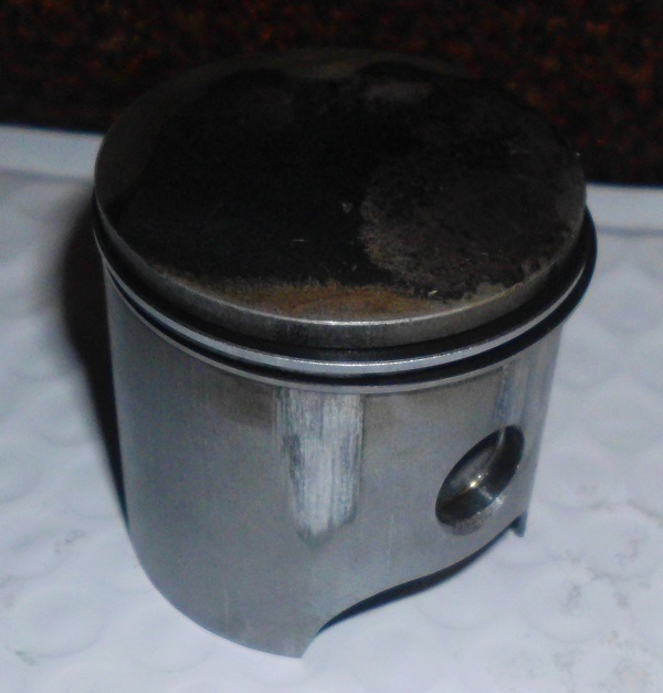

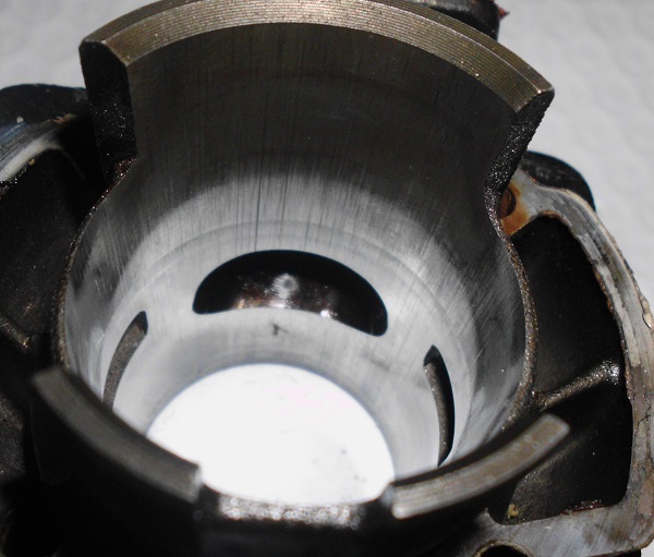

8080 miles
148-150 psi compression
klotz R50 32-1 since day1
7000 miles +- roughly on bore
decided to put new bore on it
honed and sold old bore with new rings
166.0079 chrome top ring
206.0200 cast bottom ring
209.0383 gasket kit
fyi 204.690 is replacement corsa piston kit stock bore
no marks could be felt with finger nail
