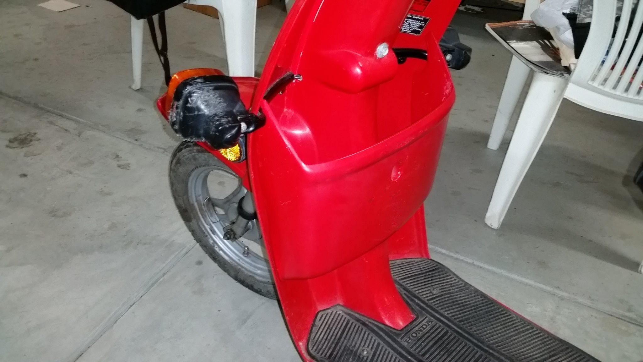

Here is how mine came out. Glove box off a 87 Spree onto my 85 Spree. Filling the holes was a bit tricky. I super glued a couple of old credit cards on each side and then bondo. Came out ok.

toohyped wrote:Here is how mine came out. Glove box off a 87 Spree onto my 85 Spree. Filling the holes was a bit tricky. I super glued a couple of old credit cards on each side and then bondo. Came out ok.
That looks great! Unfortunately I ended up having to get rid of mine before I could completely finish it. My uncle has an 87 spree sitting in his shed that hasn't been started in about 10 years. Most likely that will be my next project...
