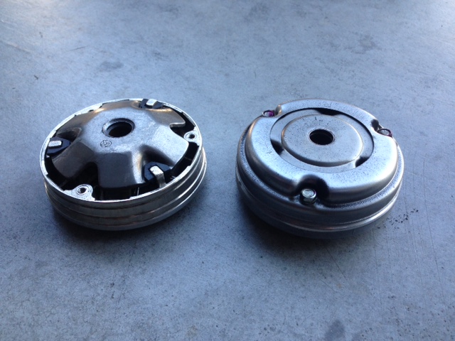

The "P" means its the "restricted" version. I just went through this same process. To de-restrict you need to get a muffler, ramp plate and gears from an SE50. They say that the main jet in the SE50P "IOWA VERSION" is #82 and if you have that then it needs to be swapped with a #85. Just the Ramp plate, muffler and #85 main jet will get you to 40+ mph. However, you don't have to swap the restricted items with stock SE50 parts. You can always swap them for aftermarket stuff which is more money but will give you more gains. Picture shows the difference of the ramp plate. The left one is un-restricted.

ramp plates.JPG (120.79 KiB) Viewed 9425 times
