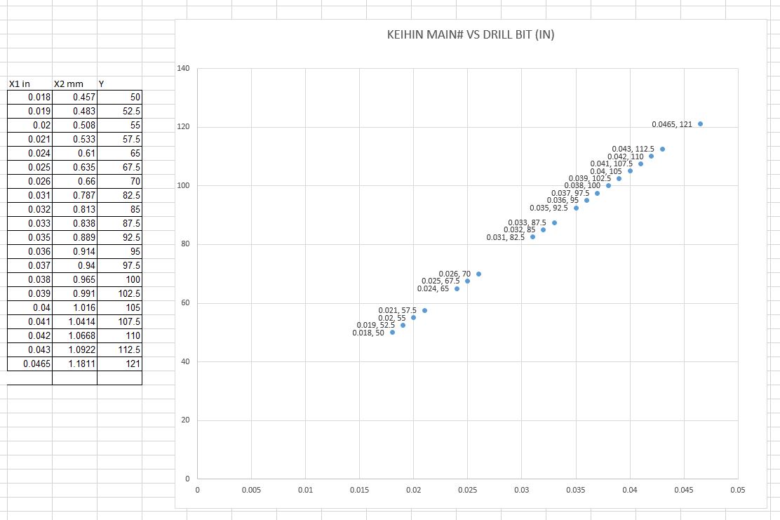

looking into drilling pilot. decided to extrapolate some data from the wiki links in this thread:
viewtopic.php?f=1&t=32950
keihin main vs drill bit in.JPG (94.92 KiB) Viewed 18873 times
plotted data, and got this linear equation:
Y = 2500(X)+5
Where Y is main size, and X is drill bit diam in inches.
However, I'm not sure the relationship between main and pilot sizing is same..
from noiseguy on that thread, a .009" bit is a 22pilot
yet equation nets 27.5
only local option for micro drill bits is Harbor Freight, with smallest bit of .5mm, .0197"
which is a jet size 54 using equation, or a size 48 using proportianal comparison w/ noiseguy's #'s.
if stock is 34, 54/48 sounds like a considerable jump. debating trying it anyway, ordering drill bits online, or just leaving as is. YES i still want to keep pod 8)
could all be waste of time, if anything at least this equation can be useful for someone drilling custom main jets! :lol:
projects galore :nerd:

Okay try something out for me Toast, what size is the hole for the air intake, use paper to protect the foam from tape and mock up a prefilter out of paper that woukd match the stock air intake size and enlarge it (insert %of bbk added to the stock bore ) and make the filter off. Duct tape the paper as not to accidently tape the fikter and slide the paper "resistor" onto the pod. Now use a rubber band around it to hold it on and try that out. It will need a jeting change but it should give the back pressure of a stock airbox and fool around with either adding or taking material away from this paper-taped pre filter until it runs good. Then make a permanent prefilter restrictor out of duct tape taped to itself still to kep the filter from getting torn up and hold that on with rubber bands. Then search for a cone filter that macthed the size or custom order one from k&n and then your stock carb will enjoy its intake flow. From how I understand the stock carbs are very good carbs, but suck for modificaci├│n.
If this dosnt work then I woukd address a piolet, but thats a ton of work to adjust a piolet on that carb as it is pushed in correct?

The stock jet is a 36 if I rember from the other post correctly
Taz sells a sa style idle at 38 2 sizes up from stock sa jetting. Well if we know the bit size for the other jet size and then know the bit size for this guy http://m.ebay.com/itm/Honda-Spree-NQ50- ... nav=SEARCH
You could make a graph of the scaling to make a drill bit refrence sheet to every size of pilots via drill bits.
Or you could order that jet, find what size drill bit it is and step up the stock drill bit in your current carb slowly until it runs right and post what size drill bit you used for other people using a 72cc cast kit.
